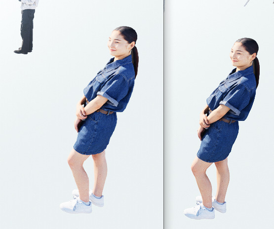

Any ideas why the crowd look dirty?
Still can’t figure out what is causing this.
Left side is my output render. Right side is D5 Viewport.
Its just people and a plane. To make the scene simple. Still the same.
If I hide everything and just render the people its clean.

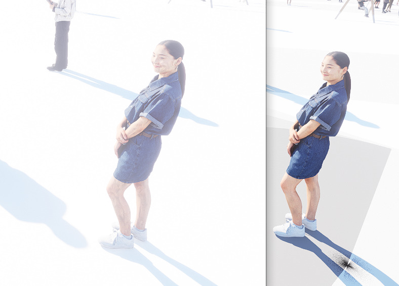

By doing some troubleshooting. I encounter the problem on the Sun and Sky render. On HDRI it does not happen.
I’m wondering now if the file is just corrupted. Since it went thru multiple crashes along the duration of project.
On a clean scene. Rendering characters on any setting works and is clean.

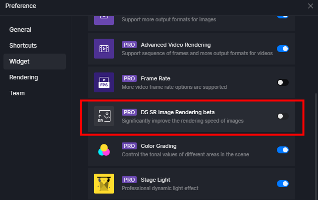

did you turn on the SR widget? Please turn off it and try again to see the results.
I will try this. Thank you.
This problem often appears when there is an object too far away from the origin point. You can select all items from the object list then check which one caused the problem.
We will fix it in 2.7.
