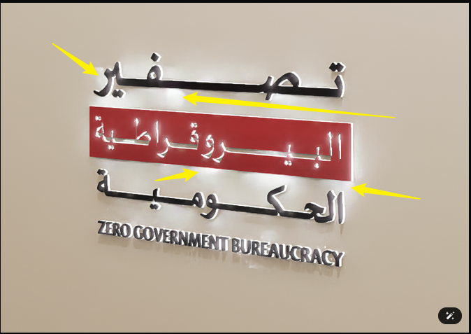

how to fix this issue? this is my first time having this when using d5.
Are you perhaps talking about this light effect?
- Have you tried reducing the Bloom Effect?
- Perhaps modifying the Light Intensity of this Emissive Material will help, please try.
Try turning off cast shadow option
i have the same issue, but if i turned of cast shadow the light effect will be different…
anyway to solve this?

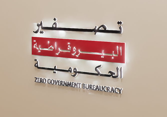

now it’s perfect,
