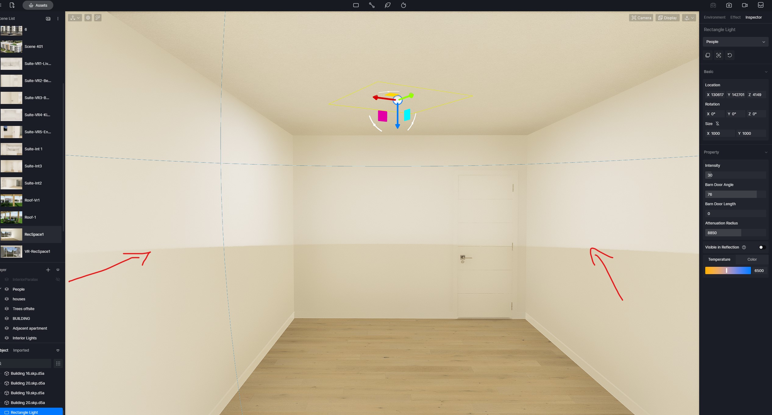

When i use Rectangle Lights, there is a horizontal reflection that appears regardless of what material is applied to the walls. I have tried settings for the light and the wall material. How can I remove this?
Hello, this problem may occur when the light source overlaps with the wall, you can try to move the light source down. If the problem is not resolved, can you send this scene to our support center (support@d5techs.com)? This can better help you troubleshoot problems. :smiley:
