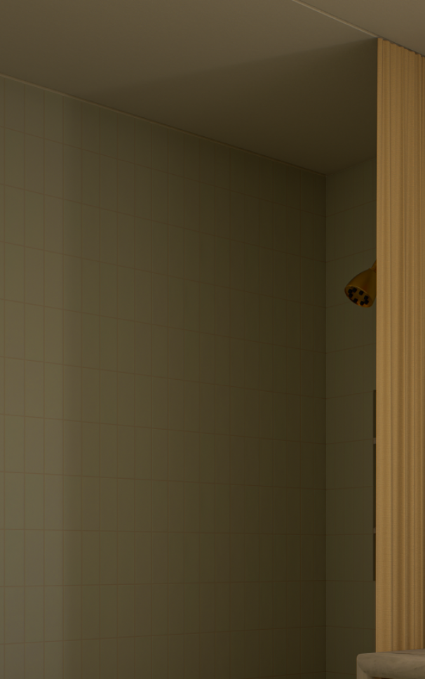

I am rendering a bathroom part of a bigger home. The bathroom does not get direct sunlight unfortunately, and I need to use a rect light to show some light from the window. I usually don’t do this as most of my scenes have sunlight, but for some reason I thought RECT light had the option to choose the radius, and softens shadows. Unfortunately It doesn’t, and now my render has an unnatural shadow line. I don’t want to use point light, as it will illuminate the garden scenery. Is there a way to add light shape radius to RECT Lights? I think I remember having the option in older D5 versions.**

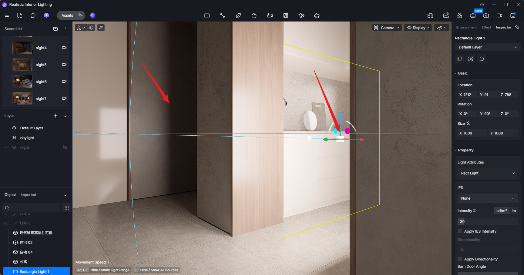

Correct me if I’m wrong but, this is the placement of your Rec Light? Perhaps similar?

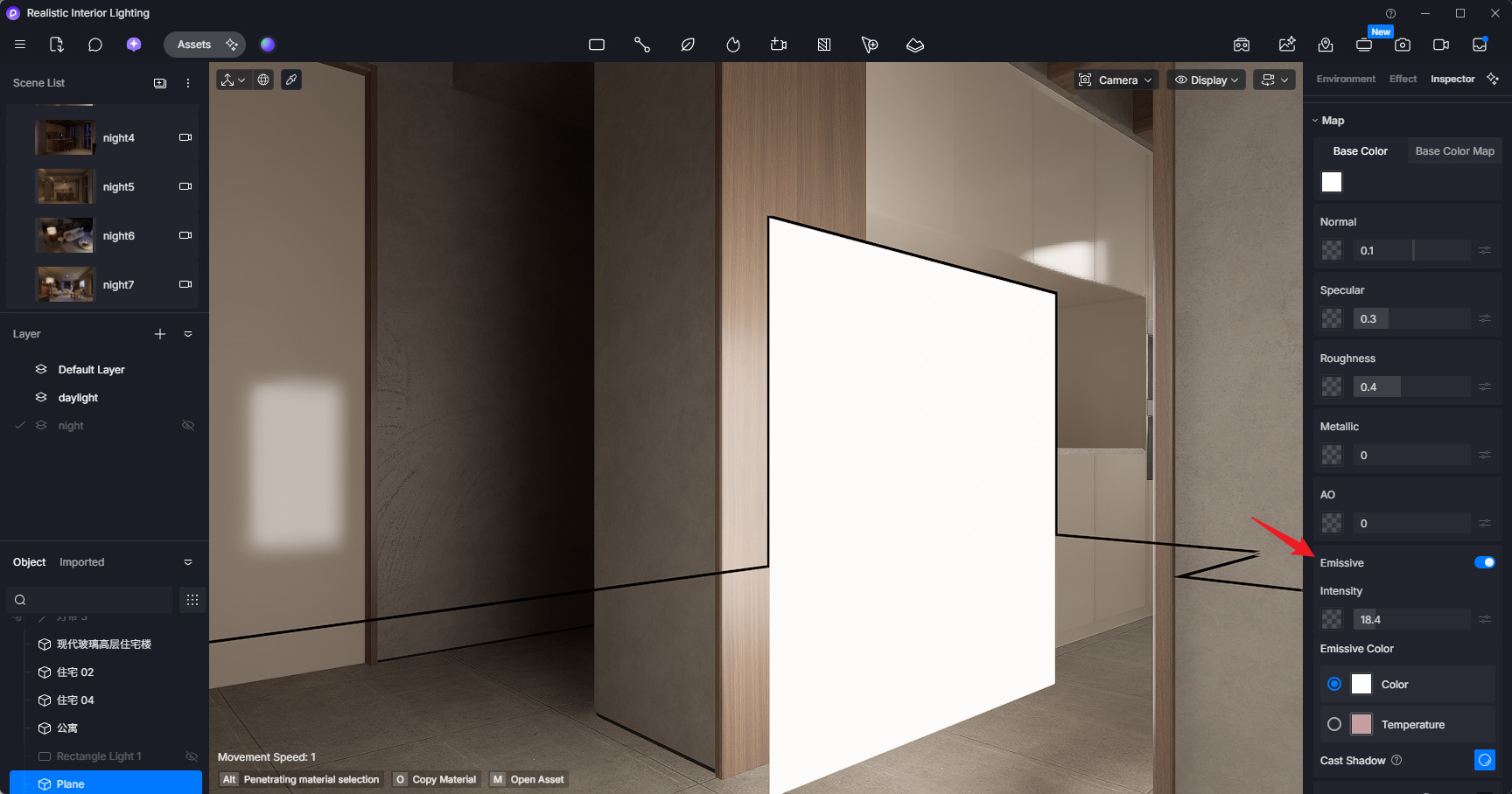

  • Try using an emissive material. Insert a Basic Plane asset > Resize > Enable Emissive option
Hi Clov,
The problem with the plane light is that I cannot control how far the light reaches, and it shows as light source, and also cannot hide relections of it, making it not ideal.

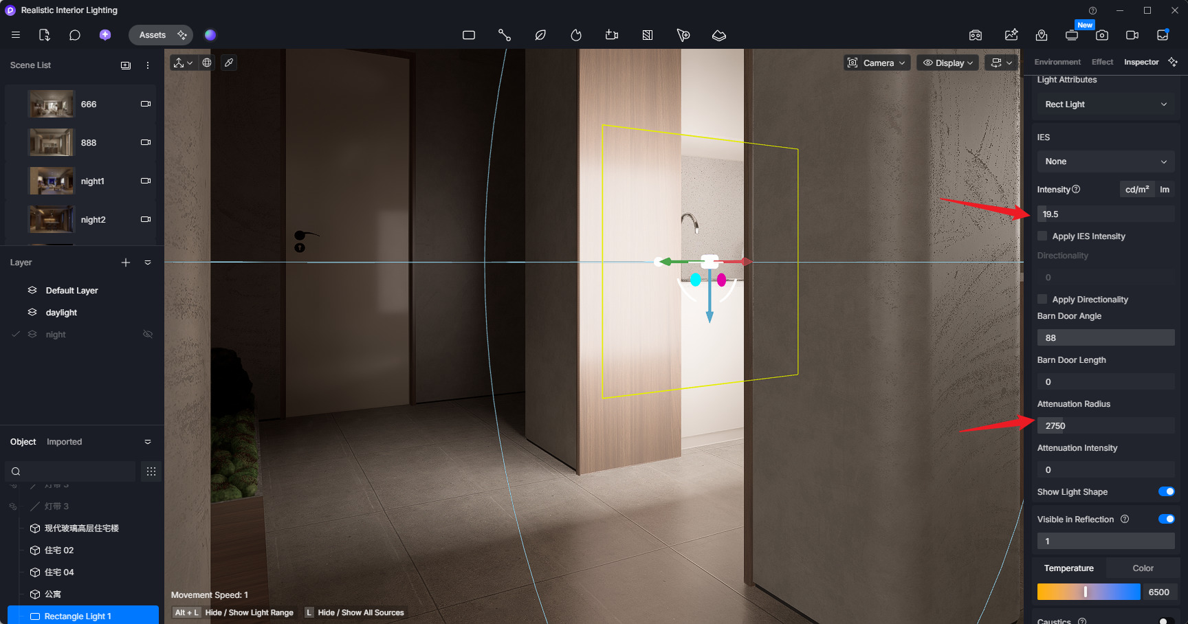

Try to lessen the intensity and attenuation radius?
