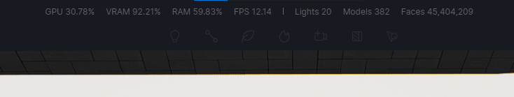

Another thing you can do is activate the statistics feature. This is to monitor your VRAM usage in reel time. Once it goes over 90%, it will cause many irregularities, e.g., lagging, freezing, slow rendering, and even crashing D5.

I’m using the latest version because I’m a PRO user. It’s something that happened to me for so much time, slopy and laggy performance when I start to add vegetation or grass. If I close the program and start again I can work better, but after a few minutes of working or just for a while, everything becomes slow, dense, and hard to work.
In my third image, you can see the statistics about the computer and performance. Yesterday, after a video render, the software was running at 5 fps, that is a NIGHTMARE in terms of performance. And I know I don’t have the most powerful PC in the earth, but really? With my processor and GPU, other 3D software is faster.

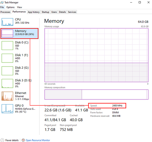

Hello, here are the screenshoot that you asked for, and if I reduce the size of the window, like some years ago, the performance is increased. It can’t be the same solution because I in this time I’ve changed the graphics card, the CPU and even the amount of RAM.
Hello,
  • D5 mainly uses dedicated GPU memory, and when this figure exceeds 80%, D5 will probably crash or display unsatisfying performance.
  • How is the performance when you use other scene files, such as D5’s demo scenes?

And other thing, when mi Pc is rendering a video, the GPU is not fully working, like just 25% or 30% of the GPU usage.
And this is the WORST part so far. Spending at least 10 minutes with a huge lagging my whole PC (mouse cursor, keyboard, etc) the percentage still at 0% but look the CPU, GPU o RAM… WTF! They don’t reach 30% of usage, and still after the render “begins” the PC is almost with micro freezing for microseconds.
That amount of problems just for the GRam? I can’t use D5 Render with a RTX 3070 and some trees and bushes?
And again, during the whole render, the GPU don’t reach the 40%
