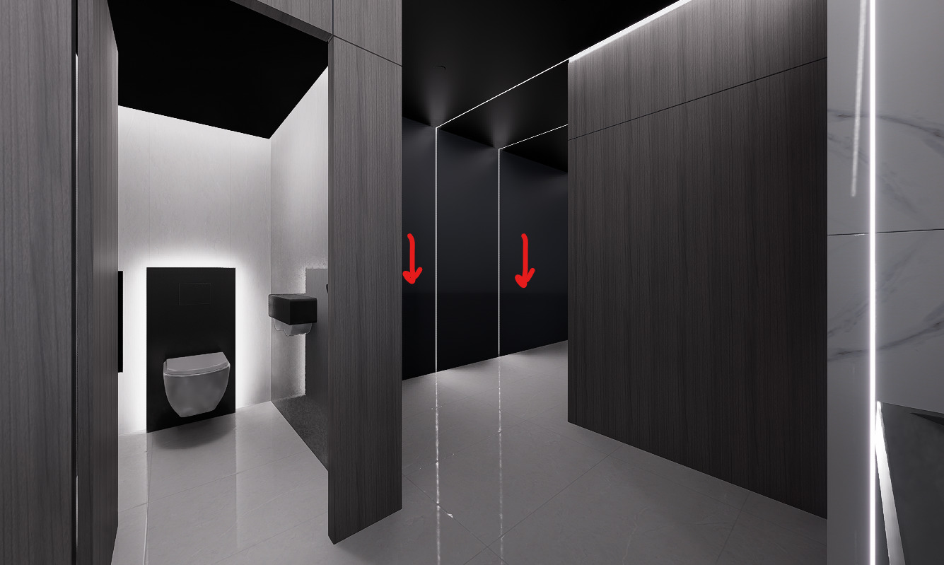

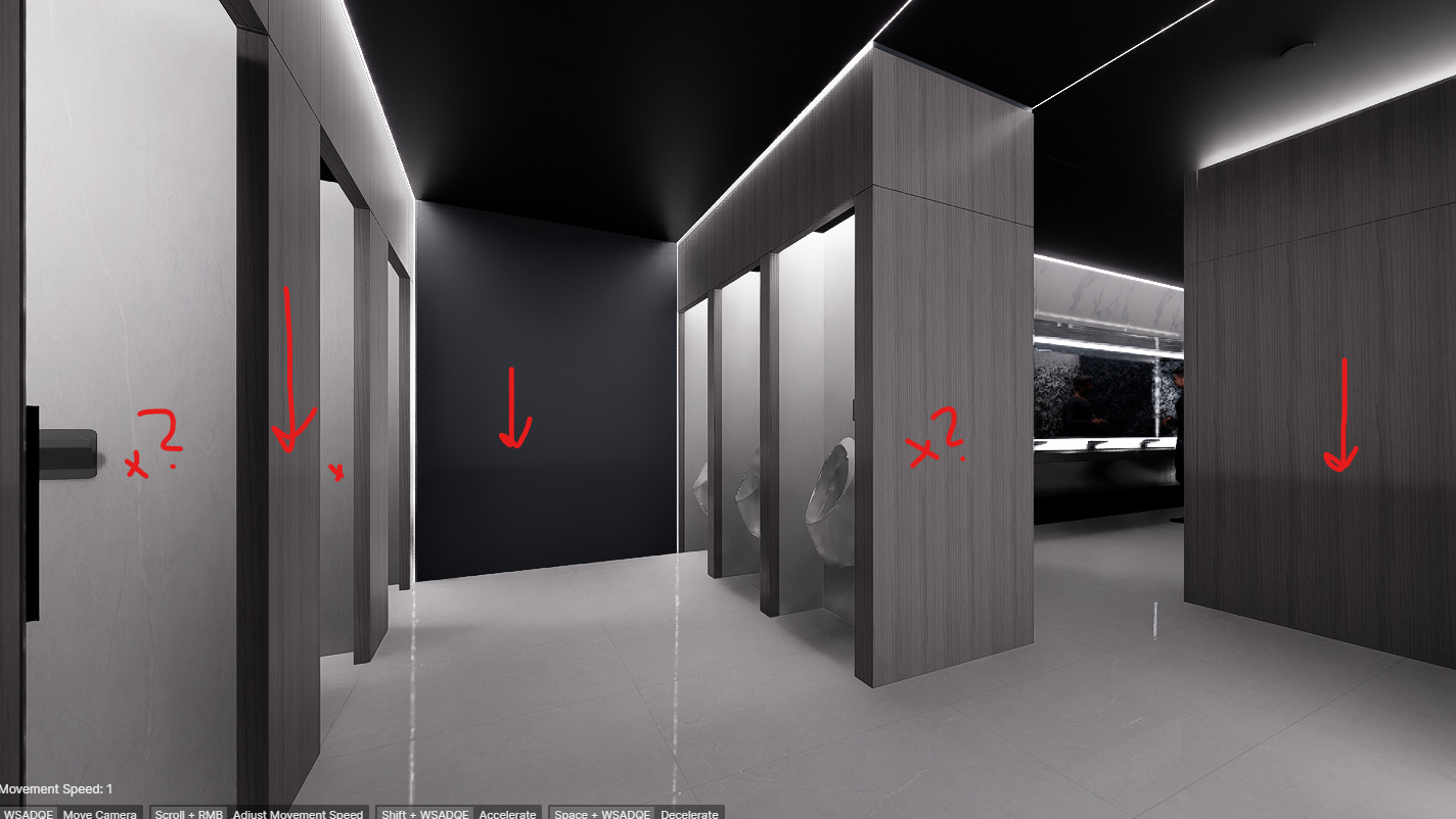

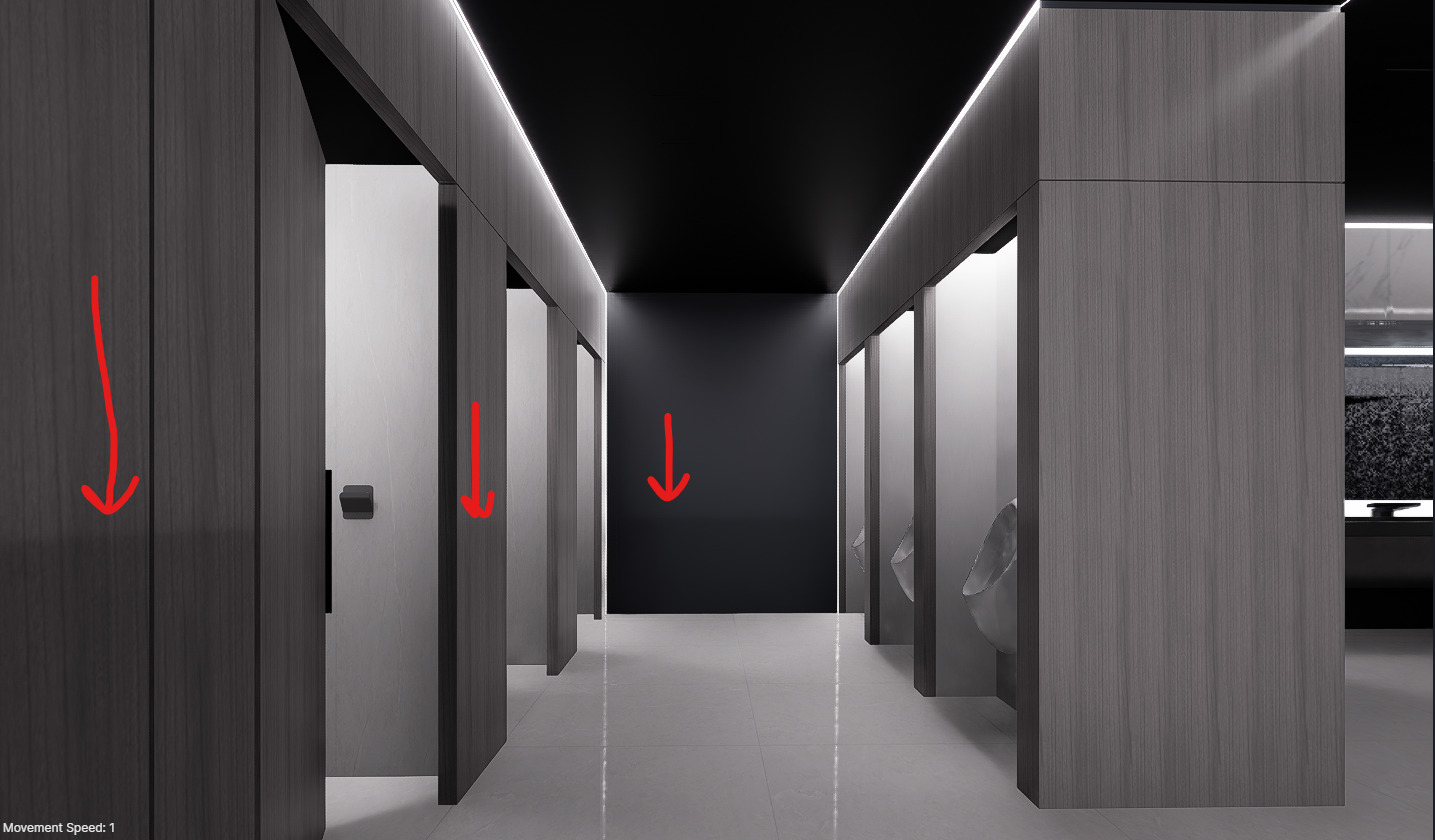

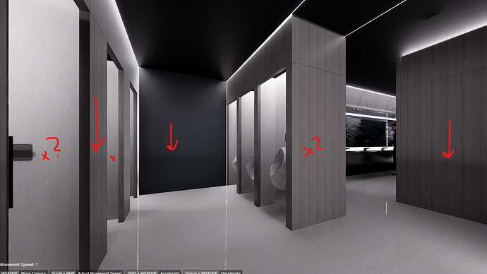

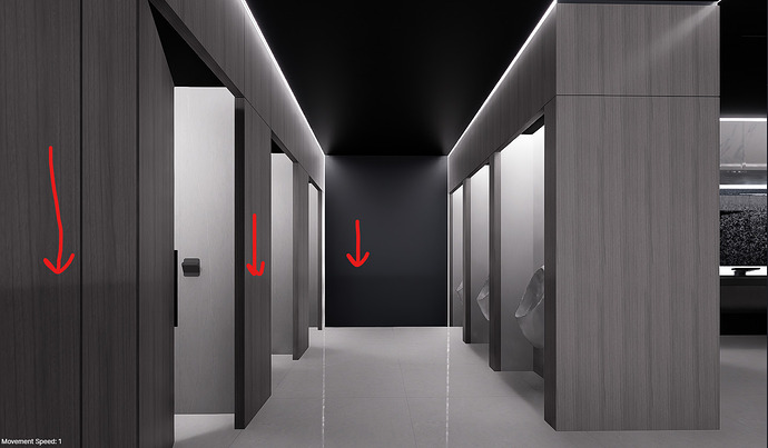

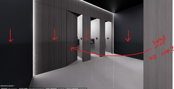

Can anyone help with this error? Getting a horizon line reflection, on an interior rendering, with zero access to the exterior from which it would have been reflected. What is more is that the exact same material shows it in some areas but not others.

-it appears to be a watermark, but in such a random location, and not able to be affected.
