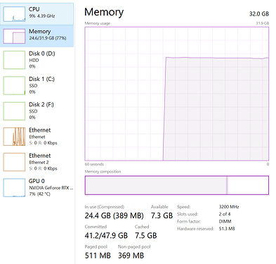

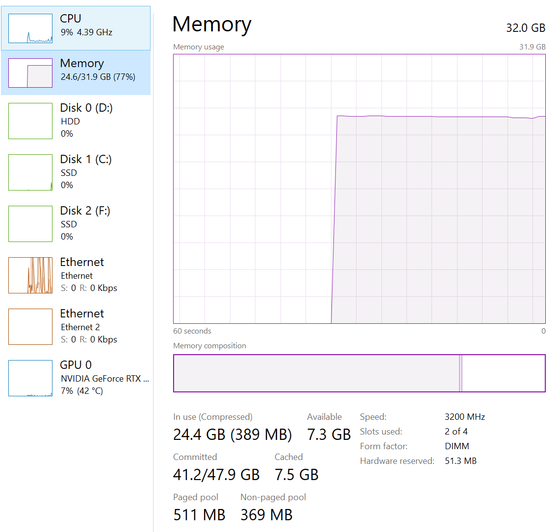

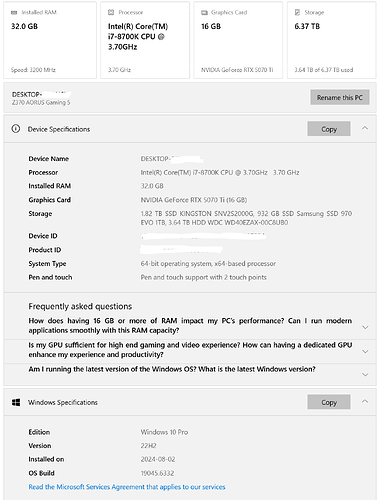

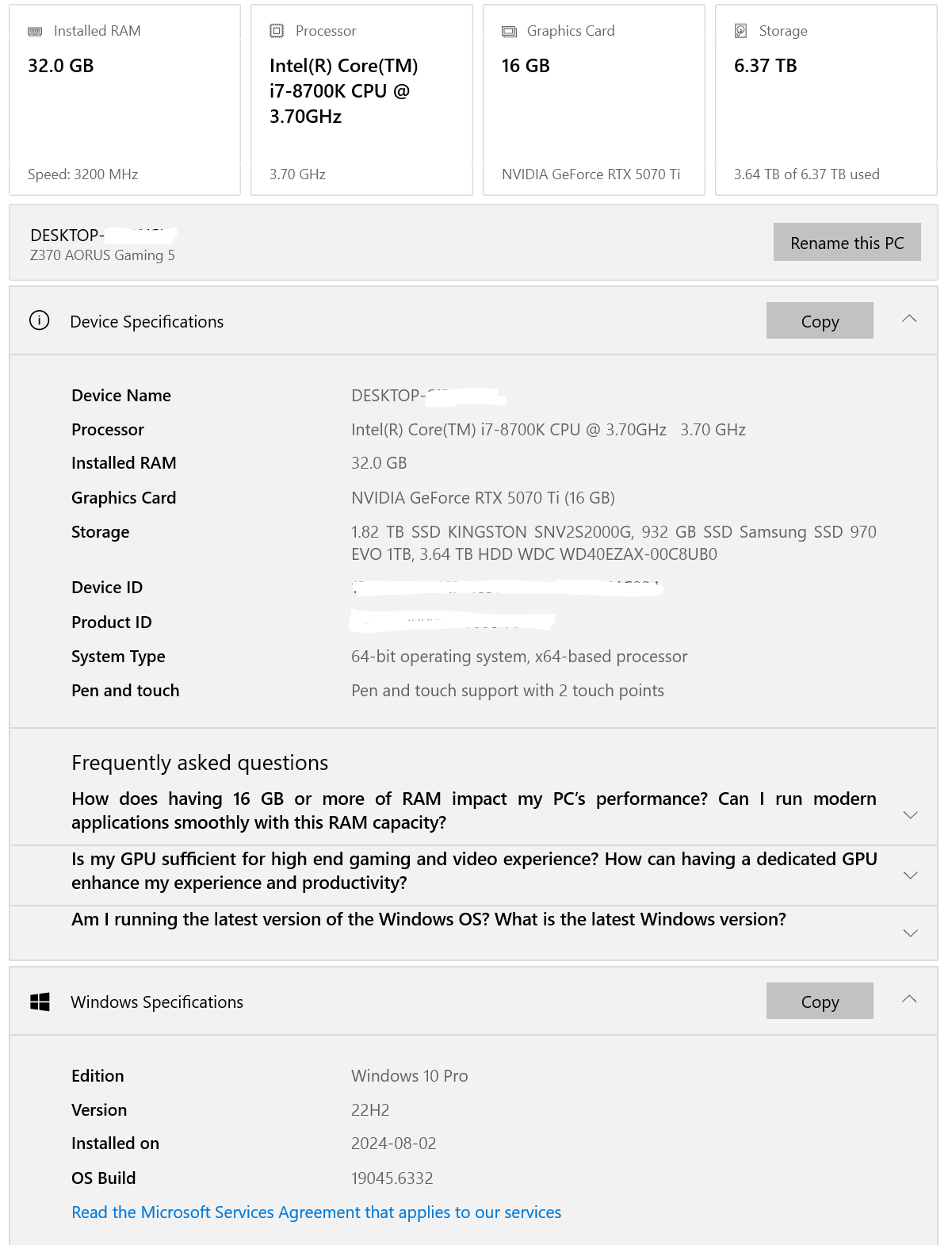

Is there a significant impact in the fact that my default Folder repository of D5 is located on one of my HDD, and the software is located on my main SSD where my OS is ?

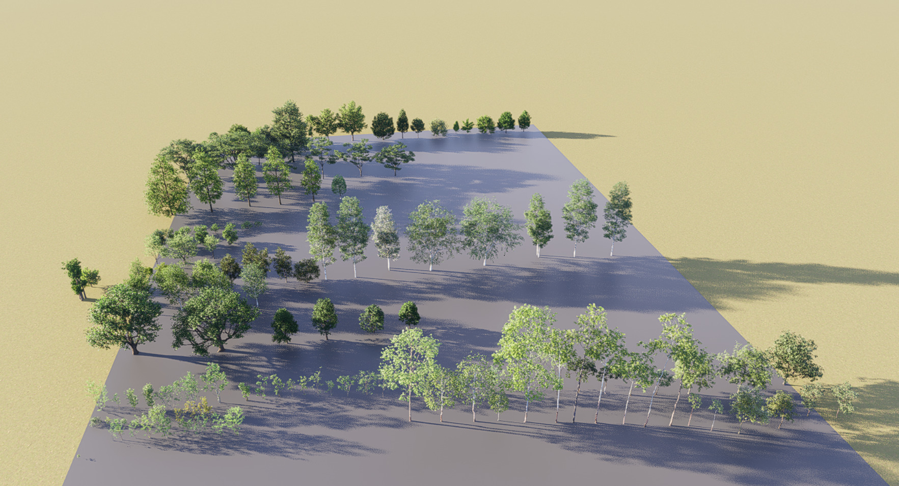

** My D5 file, with around 100 vegetation assets, take about 7 min to open.
Also
by changing from Precise to smooth, I see that it goes smoother in the VP but the memory load is still the same. correct behavior?
Thanks,
CC
Hi @charles.collin.2
Certainly, SSD is much faster compared to HDD.
  • This is underexpectation, by “Memory Load,” do you mean the statistics that are shown in software, or is it from the Task Manager? It does not really update in real time; you can save your file and then reopen it. If you seek much more detailed numbers, using GPU-Z is suggested.
