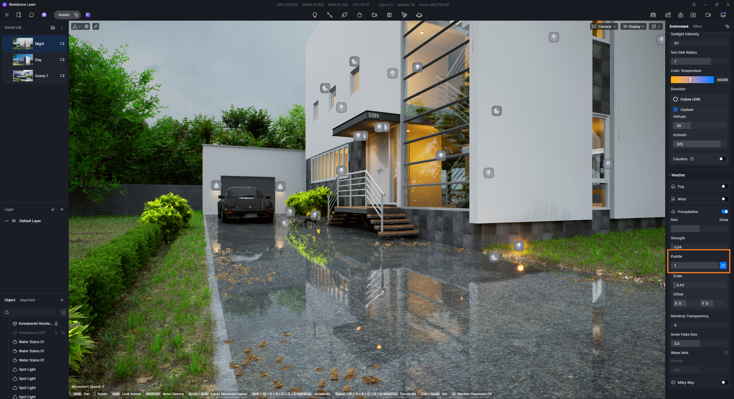

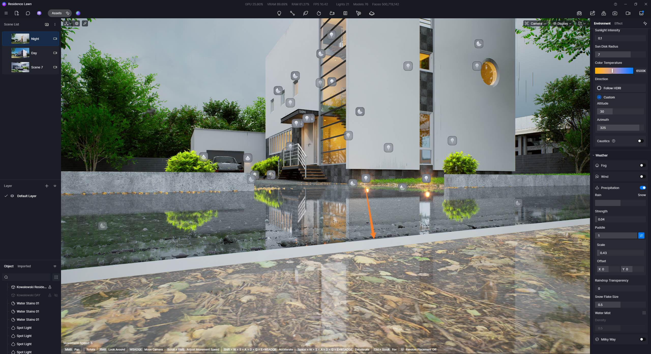

Are you trying to achieve the same level of reflectivity in the puddles as shown in this image?
  • I have maximized the puddle strength to 1.
  • Set the Precipitation slider all the way to Rain
  • The Natural Grade Line of this model is positioned directly on top of D5’s flat terrain.

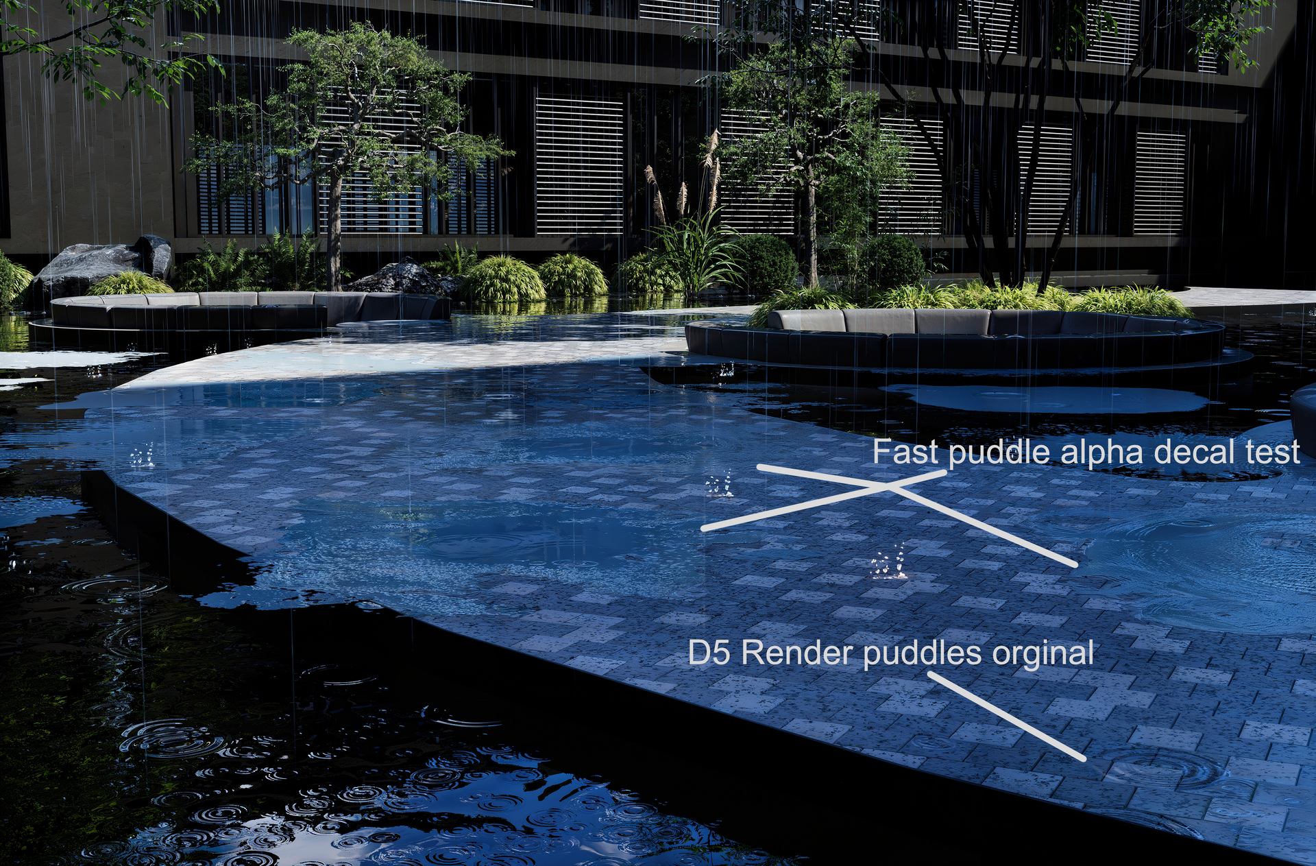

I would use a plane and a “puddle alpha map” (google) or a grunge alpha map as opacitiy map for the puddle and then play with the other settings.
So it can look like this fast example: :smiley:

Best is various puddles and then the mix with the D5 render waether settings. But yes D5 can only no water (puddles 95-96 %) or you will need a Arche Noah (puddles 97-100 %). Perhaps in the future there is a option like a scatter…
