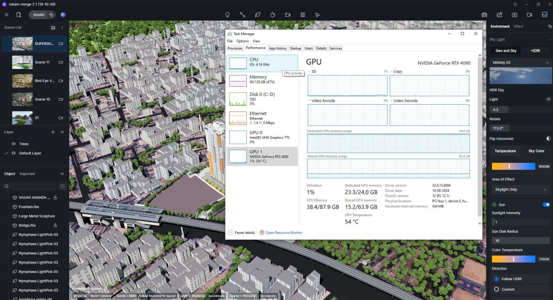

Hi @lokesh.d, It is most likely that your file is too heavy or overloaded. Please does the crash happen only on a particular scene? We’ll like to know your VRAM AND RAM usage while running the scene, please share a screenshot of the statistics as shown in the image below.

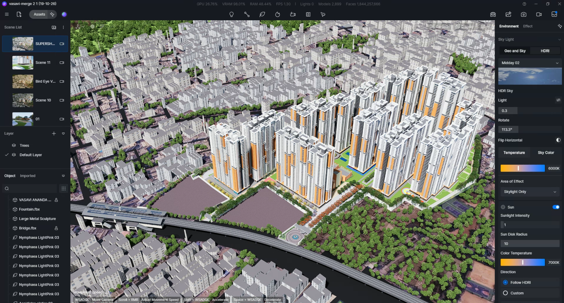

Hi @Anthony_D5,

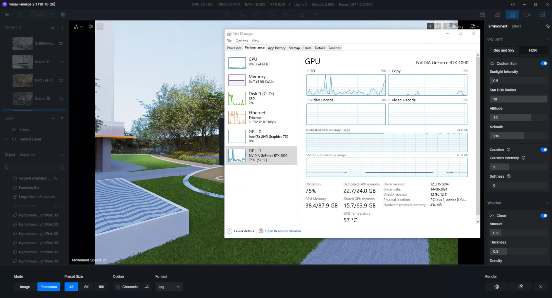

I am sharing the screen shots of the stats when I load the project vs when I put a scene on render - panorama/4k
It crashed when I was putting it on export
  • 4k)
Hi @lokesh.d ,
From the screenshots provided, we can see that you’re using over 90% of your GPU resources while working on the scene. Please note that your GPU becomes unstable at over 80% usage and may result in D5 crashing.
