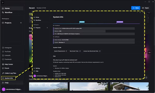

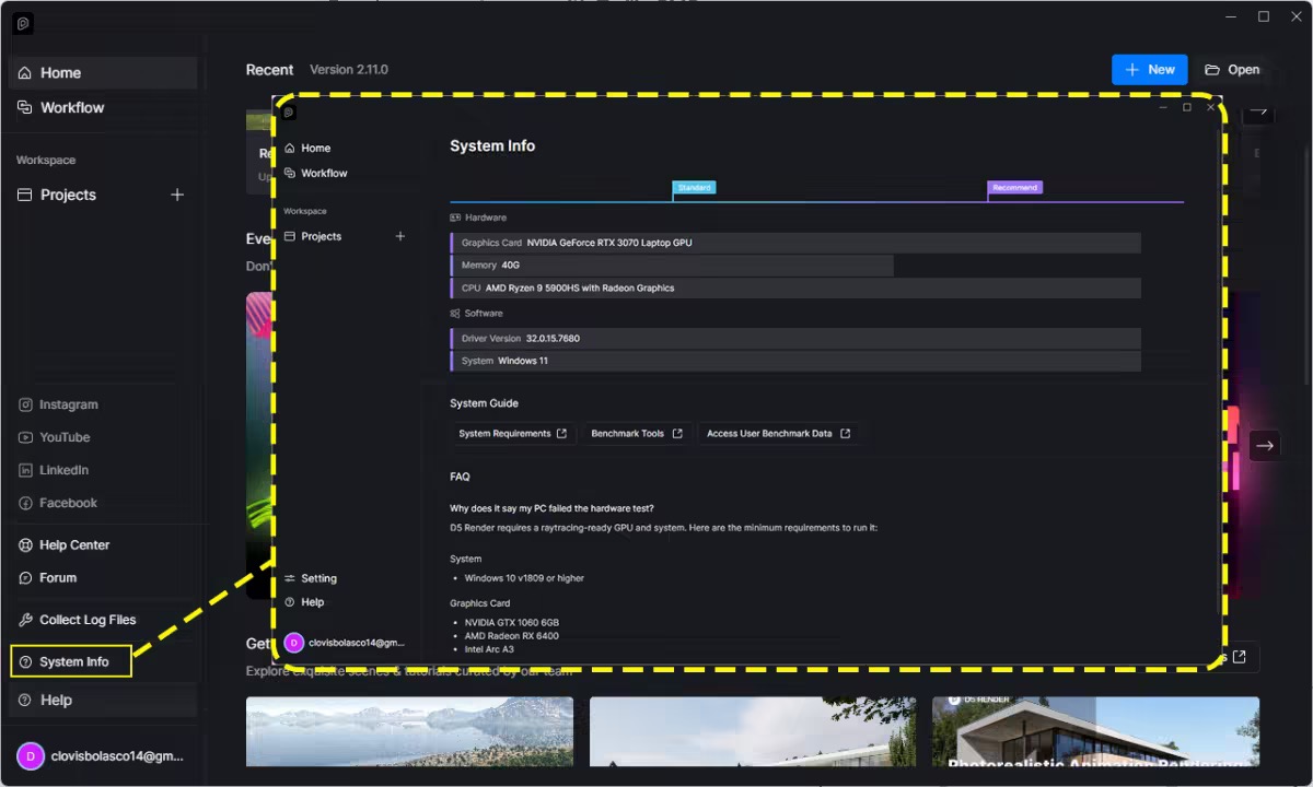

Please send us the following
System Information

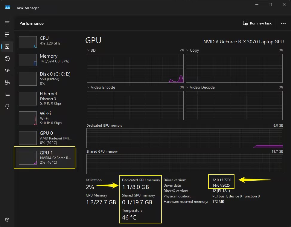

VRAM - Try to open the file that’s causing you problem while screenshooting this portion of your Task Manager

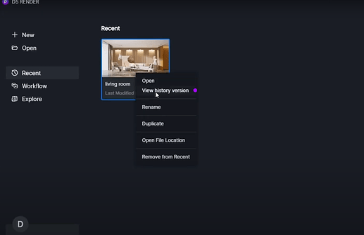

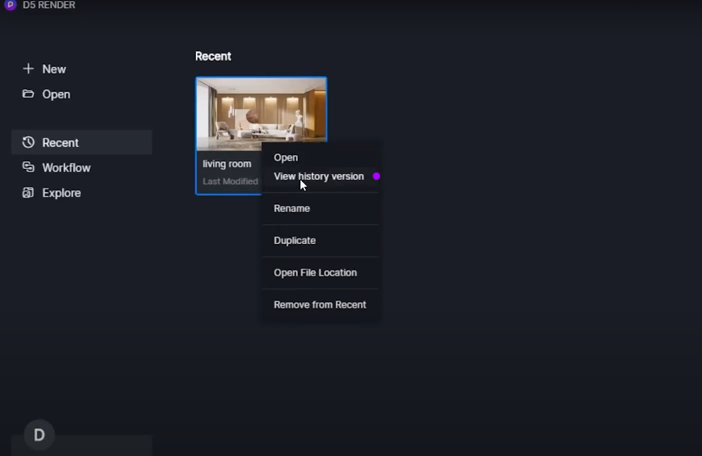

Try to access file version history
