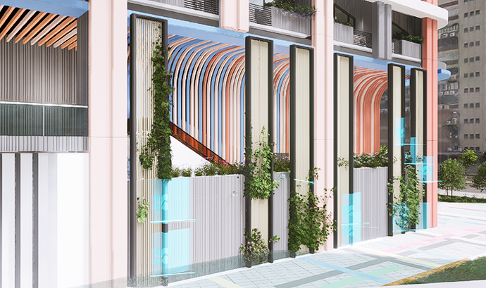

everytime i open the file all or most of the procedural vines/plants dissappears and or regens to another form seed. but most of the time its just this blue icon and with no plants in it.
any fix?
any fix?

Procedurally-generated vines regenerate each time you open the archive, but the plant type should not change.
Just for confirmation, did you modify the model file and re-connect with D5 via plugin? Or did you ever hide the model in D5? If you click on those blue placeholders, what will it display? Can they be updated?

Hi, it’s a known problem since the beginning. If you want to use it, you have to make the renders when you placed the creeper, but know that when you modify the project, the shape of the creeper changes, and you have verified this, even when you synchronize it, it changes every time.
To avoid having this problem, I wouldn’t use it, until the D5 team solves this application, I would use climbers already complete with shape, or I would put a shape on the wall you made, of a shape as if it were a creeper, but transparent , then I would fill it with the bucket taking some leaves from the catalogue, like when you make a hedge.

yah i know every trick in the book in creating VERTICAL GREENS fake or Real so i know my way and how to cheat… i was just concern about the PROCEDURAL VINES… now its CRYSTAL CLEAR im not alone
many thanks…
I hope they can find a fix or add an option in the Procedural menu to “FREEZE” the growth or random seed activation each time u reload/mod/update your file.
OR give us the Option to RE-GENERATE all at once using while all the procedural vines are inside a group… an option to click “GENERATE” this i thnk can help everyone for the time being.
