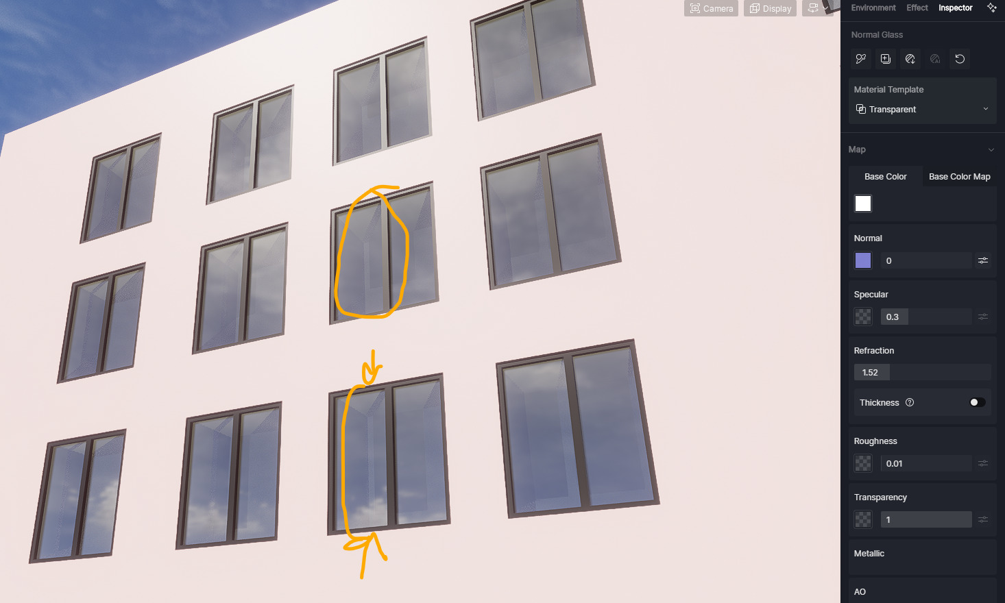

- Weird refraction effect, appears only in new version. This is default Normal glass from asset. This is not being in previous versions. When thickness active glass have normal reflection.
Without refraction

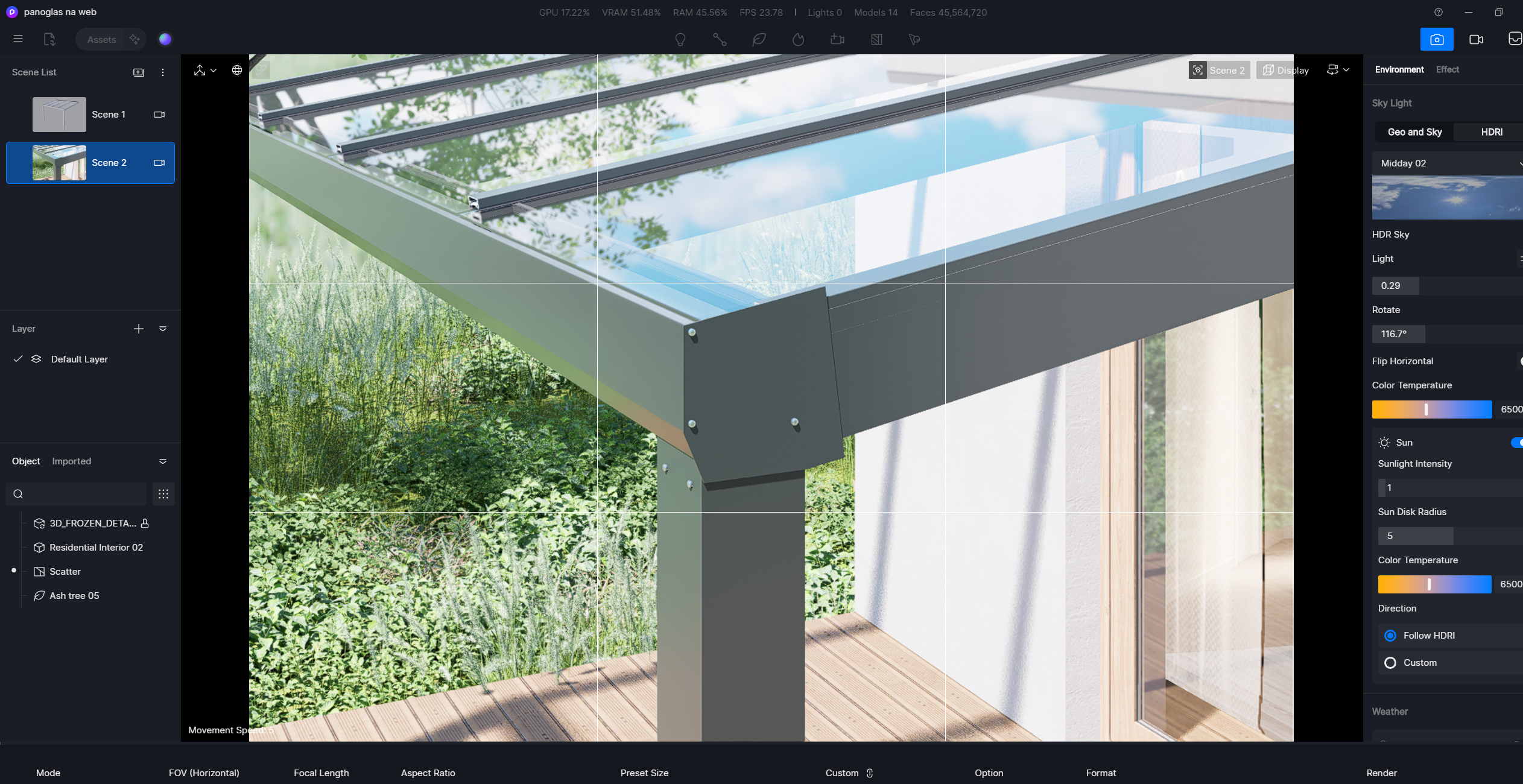

grass have some glith with shadow or texture. after choose same grass type in this material, it regenerates and came to normal

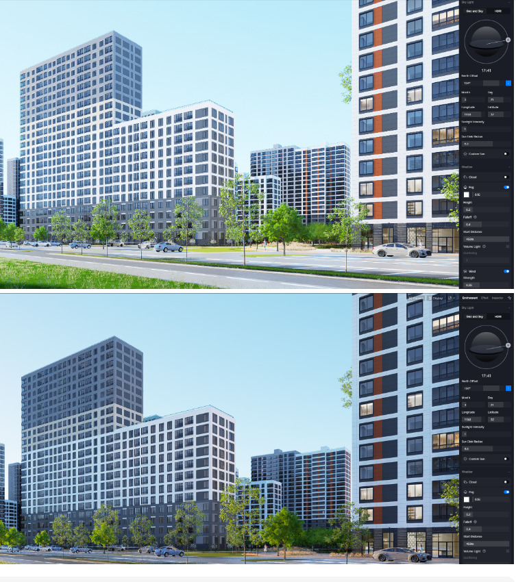

Same scene with same settings but with different light. top with incorrect light settings in preview. incorrect. to resolve need to open different scene and come back to previous. I think when I open scene, previous sun and sky settings go to it from previous.
Thanks for reporting this issues. Is it convenient for you to send us your scene file for check? You can share a link here or send your file to our email. (support@d5techs.com, please describe the problem and attach the link of this post to your mail)

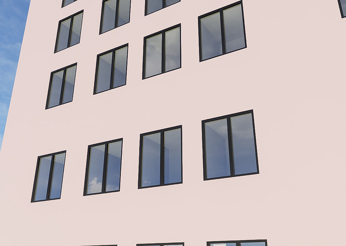

I have the same problem. When I set the camera correctly, the result is different and the D5 render move camera lower. You can see it in images.
Hi! Thanks for reporting the problem.
Is it convenient for your to send us this scene file? This may help us better solving the problem.
