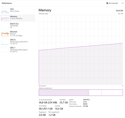

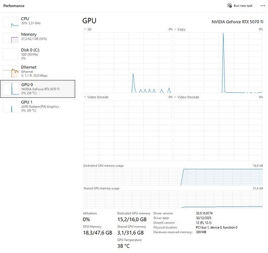

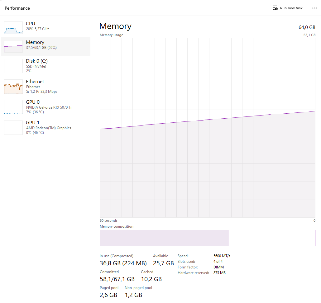

  2. What is your dedicated VRAM size? If possible, please take the screenshot while your project is open.

  1. What is your dedicated VRAM size? If possible, please take the screenshot while your project is open.
16GB
