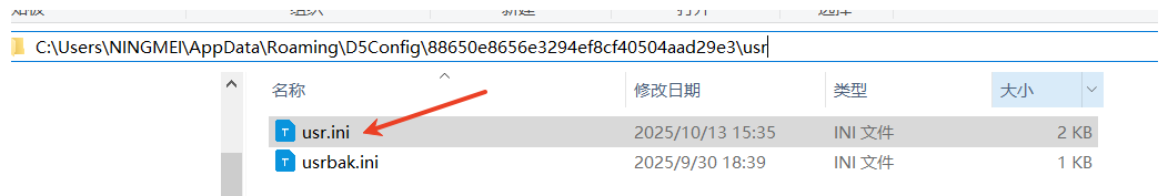

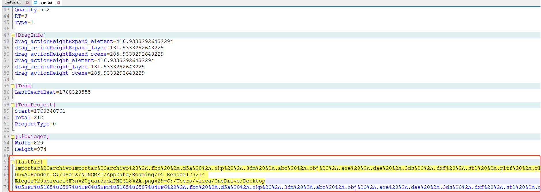

Hi there,
  1. Please locate this file and open it (you may open it in notepad), usually it is located in this address: C:\Users\xxxx\AppData\Roaming\D5Config\88650e8656e3294ef8cf40504aad29e3\usr
  1. Delete this portion, then “Save”
  1. After saving, reopen D5 again to see if the issue persists.
Another option is to just completely rename the usr.ini file then reopen D5 again.
Let me know of the results.
