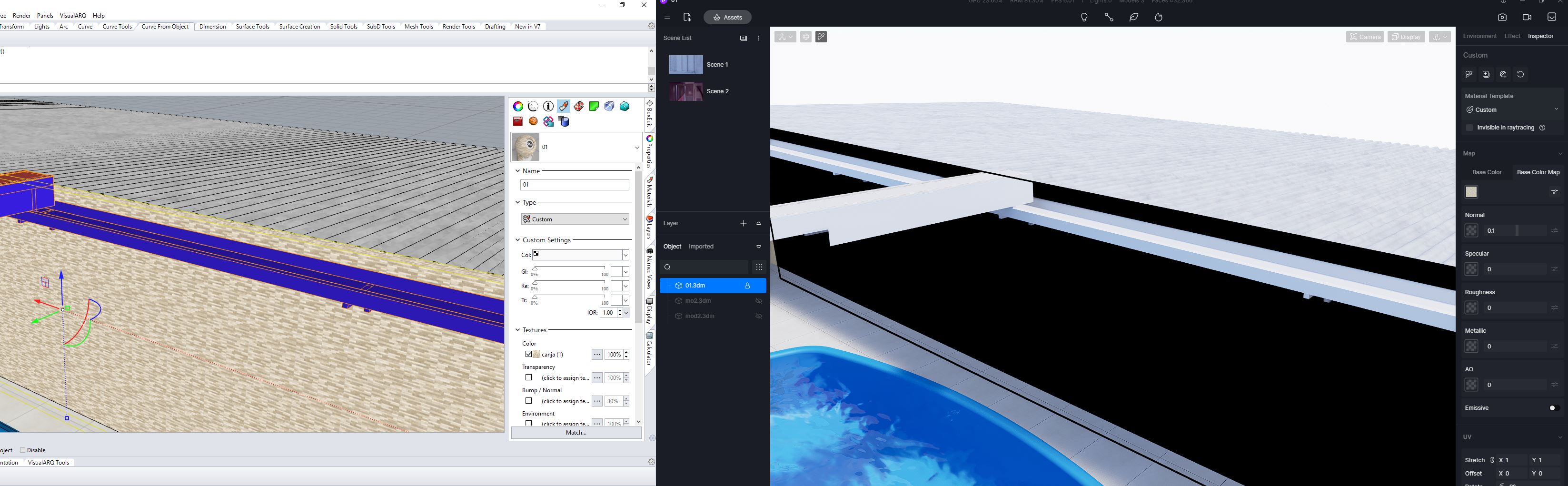

Olá, estou tento problemas com texturas acima de 1 megabyte. Uso o rhinoceros mas no sketchup apresenta o mesmo erro. Mas no D5 RENDER o mapa aparece preto comforme a imagem. Alguém poderia me ajudar.
Hi mate, please check whether this texture is in CMYK mode. You can convert the texture to RGB mode using Photoshop or other online tools, then check the result.
Also, maybe the texture’s Normal is reversed, please reverse the surface or Normal in modeling software, then try again.
Thanks friend, the problem really was in the cmyk format, you helped me a lot. Hugs
