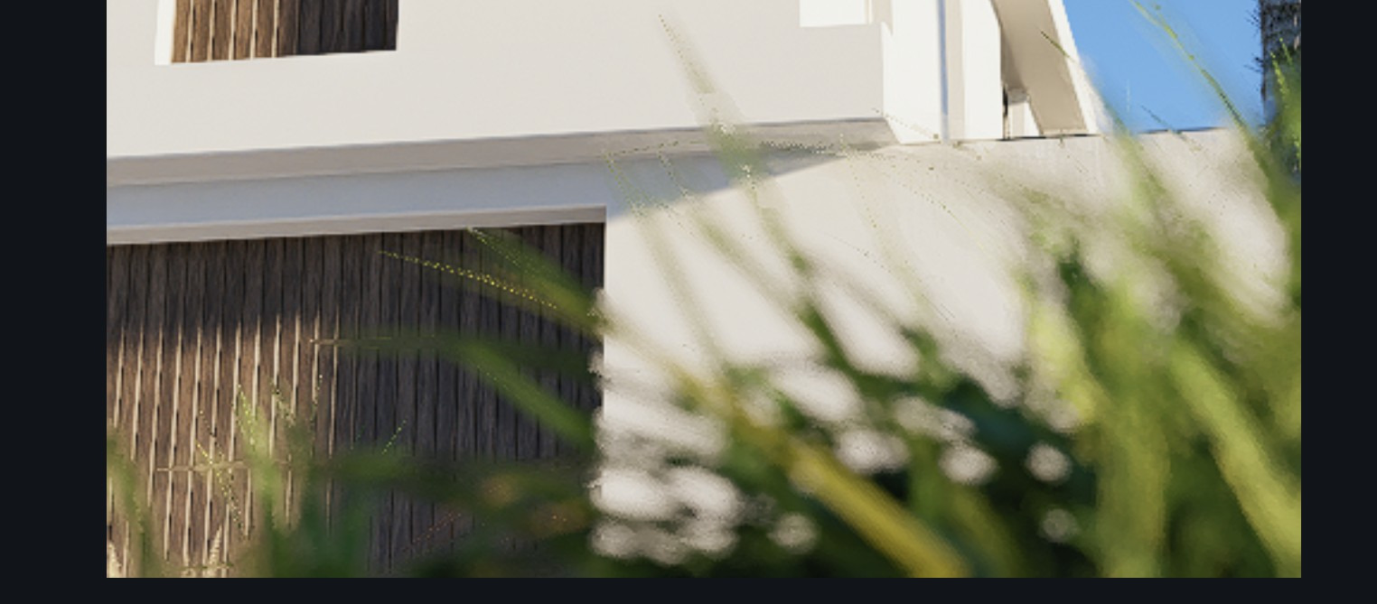

Hello! I’m having this problem with the depth of field. The out-of-focus part appears with these glitches. Does anyone know how to solve this?

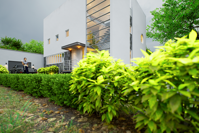

Is this evident even in the final render? The “glitches” or “artifacts” are only evident on the preview window, and after I have rendered it, the result is much clearer.
- Preview
- Final
In my case, the glitches keep appearing even after the final render. I don’t know if it could be something wrong that I’m doing. The photo I posted is of the final render.

As i can see, dof works if the camera and the nearest object are very close, otherwise i can not see the difference, i am working on booth design but when i want to blur the background i doesnt work ! i appricate it if someone tell me a solution. (excluding doing it on photoshop )
Unfortunately, we have yet to support this feature, FOV, for now only supports when objects are close to the camera. We may support this in future releases. Thank you.
