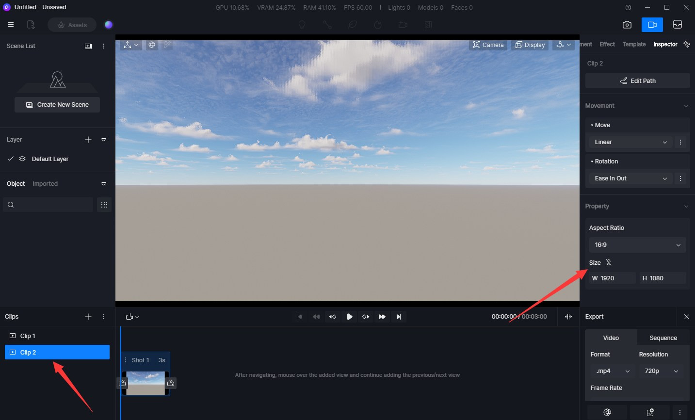

It’s a change in 2.6 Version. Now if a camera is activated and you go to the video mode, the viewport will not be in the size of that camera, like before. Instead, when you go to the video mode, the viewport will be fixed to 16:9.
If you want to adjust the aspect ratios of video clips, please select the clip and adjust the parameter here:
