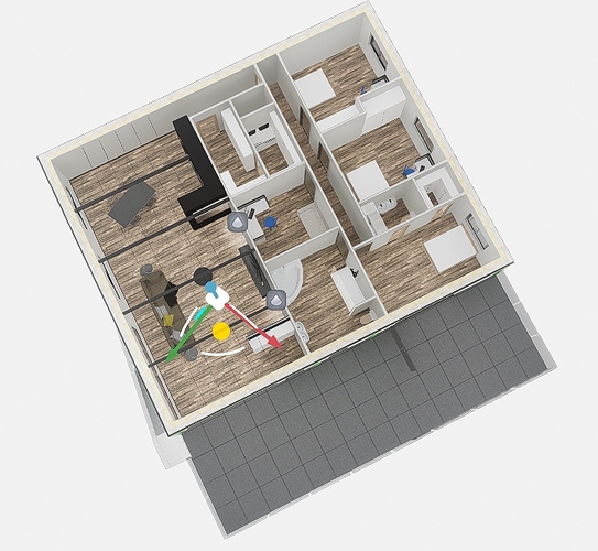

I have a problem of correspondence between the axes of the sketchup model and those of the d5 model
axes don’t match.
it seems that D5 has forever recorded the position of the skp model axes at the first synchronization. I’ve corrected the axes in skp but it doesn’t do anything in d5 and I’m wasting time.
thanks for your help

hello,
no, that’s not it: if i import an asset, its axes are not the same as the model’s. it’s practical to be able to install electrical outlets without having to rotate each object, and i can’t do that anymore.

hello, yes I tryed to sync pivot, but no way.
no, it’s always the same, I’ve tried “exploding” the first group of the skp model, synchronized again, tested “sync pivot” again and the problem hasn’t been solved.
Helloe Clovis
I’ve just done the test: d5 doesn’t take into account the change of pivot at the model root in sketchup.
Sync pivot works within a group or component.
I’ve tried all configurations
the only way to correct this problem is to orientate the model geometry in advance according to the axes of the sketchup model root. You just need to know this beforehand
