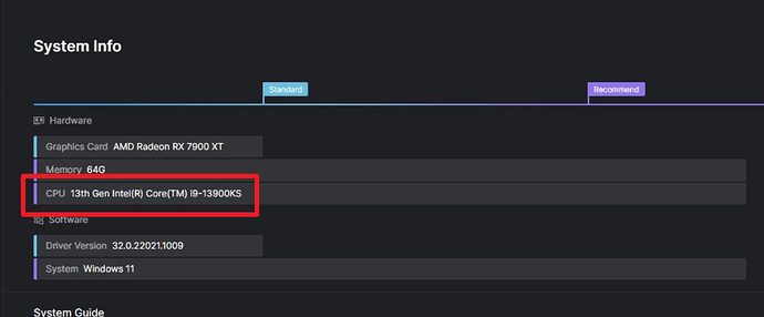

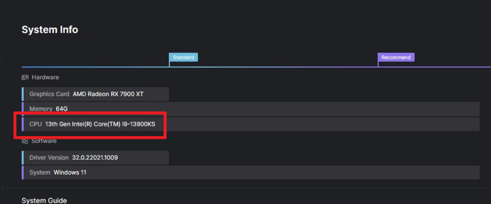

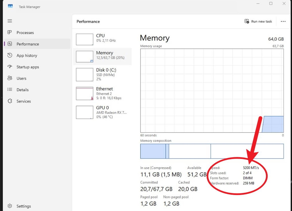

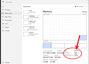

Other than that, since D5 cannot open independently, it’s best to check the following, please send us these images:

Based on the screenshots you have sent, I would like to point out the following:
