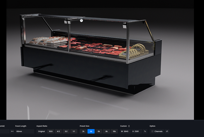

Joke aside, my preview looks much better then fished render…
PREVIEW:
RENDER:
Can someone explain me why is there reflection in preview but not in finshed render and generaly to me preview look much more nautral…
Thank you in advance
Hi @dejan.ristic89,
Sorry for your problem.
Did you turn on the DLSS? Try to turn off it.
And, what’s the Base Color of the glass? try to give it white
If the issue persists, you could send the scene file to our support team by email (support@d5techs.com, and please describe the problem).
