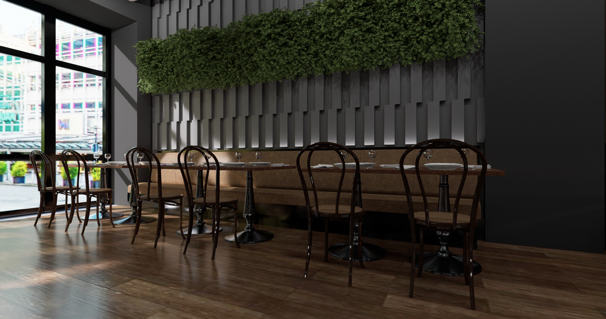

I also use Archicad and other programs too, you’re right in the end there is something that has corrupted the Archicad file, perhaps some object that you imported and put on the program file, maybe it managed to increase the megabaits. This happened to me too, but I solved it by deleting some objects and replacing them with those from D5, in this way the Archicad file worked well. I spent some time finding the solution, it was a restaurant in Germany, also published here on the site.

Then you give me confirmation that there is something very serious that bothers him. As I said an hour ago there was some object inserted with many knots and faces that make it up which weighs like megabaits, and you put several like a chair or a tree I have a car, in short as I showed you I had both plants and objects of the bar of my project that were weighing down the files. In this case you have to lighten it, even the Archicad files which usually contain some objects and mappings that are not included in the project. So you have to do a cleaning. As is usually done in Autocad or SKP, save it and see if the MB has decreased from the previous one. Or to hurry, copy your project and paste it into that of a brand new Archicad file, so you don’t carry the rubbish from before and save it, you’ll see that the MB is less. It didn’t end here. put the objects that may bother you on Layout with name and turn it off, then synchronize with D5 and see if it gives you the same problem, if all this goes well, make your images with the right settings. Then at the end you open the layers and synchronize. It is therefore rendered.
