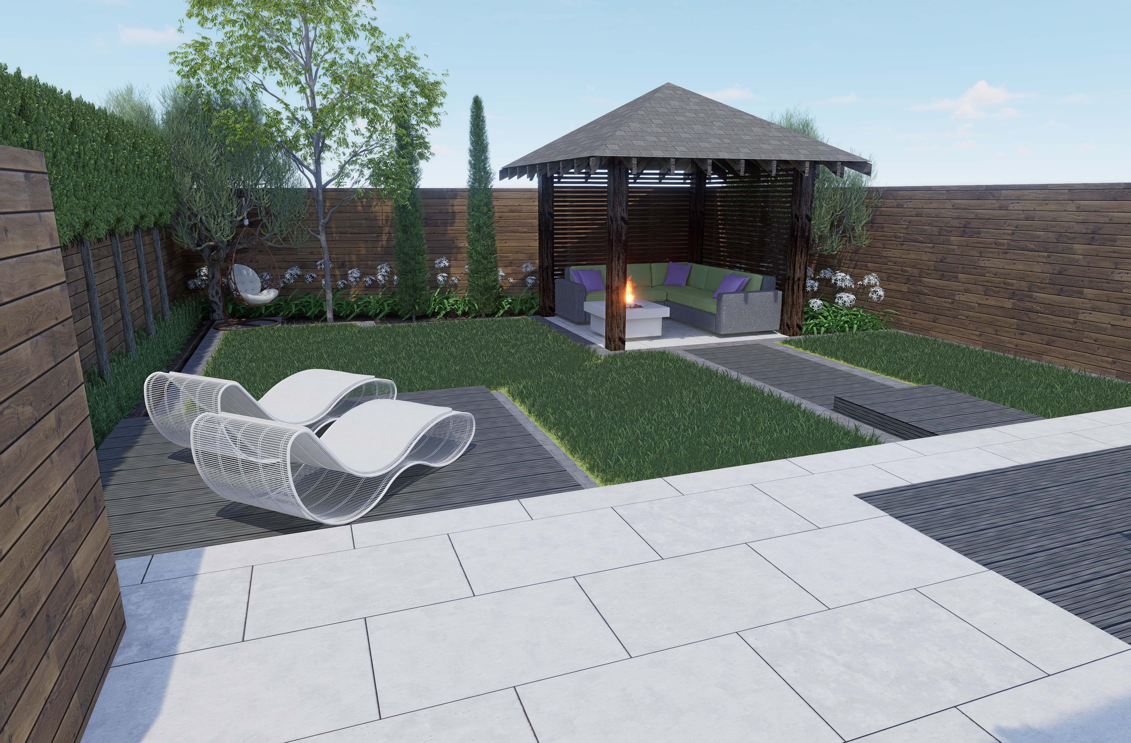

This is my first time using D5 and I’m very keen to learn so I can leave Enscape behind, but I’m really struggling to get anything remotely realistic looking. I know using an HDRi is the best option, but I need to create videos showing accurate solar paths as part of my garden designs so they’re not an option - the lighting in my model is not good at all, but I don’t know how to correct it.

Spotlight like you have in the picture may be correct in reality. Therefore work with Rect Ligth or Point light (D5) which in reality does not exist at all. Your picture has strong light contrasts and too many dark areas. Try using Rect Ligth to illuminate objects from above, below and from the side, even if it’s not normal. Try it. You can still delete if there is too much light.
