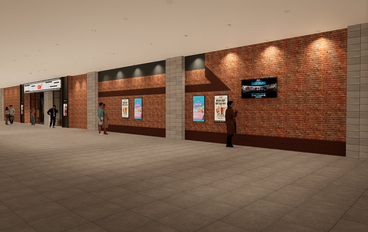

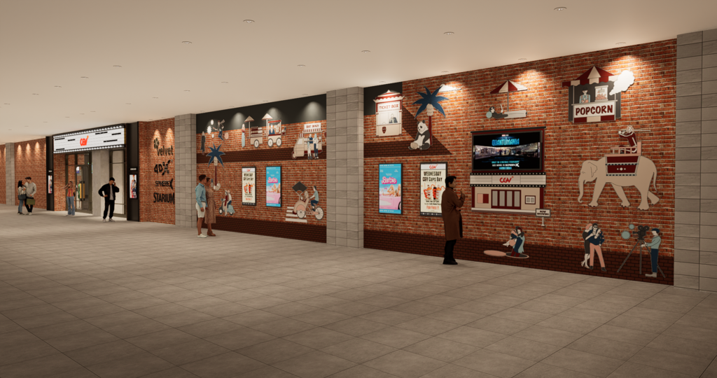

On the previous version, I attached PNG image on the wall from SketchUp, and still can show up on D5. But after I updated the PNG image was gone, need solving for this issue
Hi mate, are these png groups or components? can you explode it and check the result? Also, do you use any cloud or sever to save your work、
Thanks for the help mate, solve by exploding that png from SketchUp ![]()
Hi mate, it can be solved by exploding, but we will improve it like before, thanks for the feedback.
