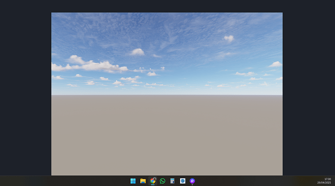

please help i am stuck in starting d5
after update ,i cant log in and if i click for star the program must be stuct like this picture

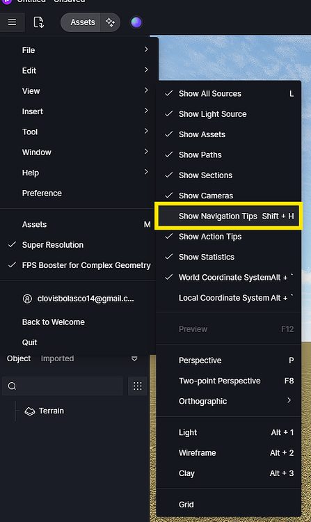

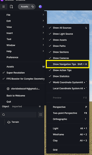

To make the side panels visible, you may activate this using the shortcut Shift + H.
