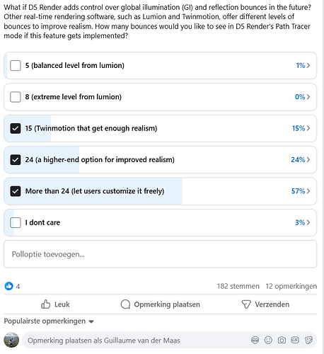

Thats bullshit: “8-12 is always enough” then he never really used tm. When going with nightshots with pathtracer on minimal lightning I need 2048 samples and 32 or 64 bounces. Even on 8K. There is a huge quality improvement. So don’t take everything someone says for granted. Still waiting for path-tracer, but I guess I will give up on that…

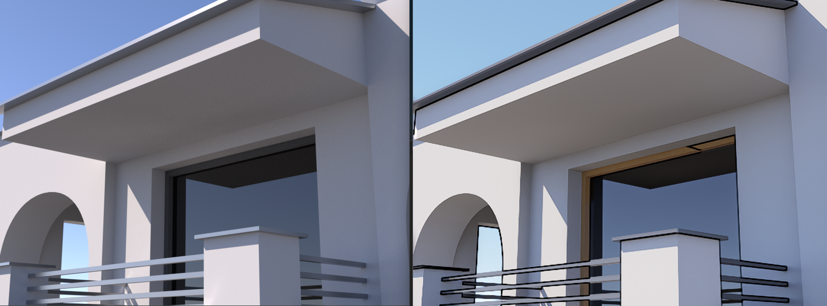

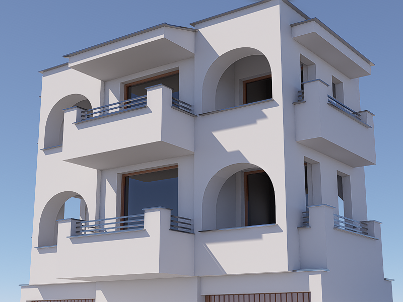

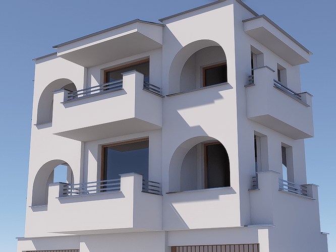

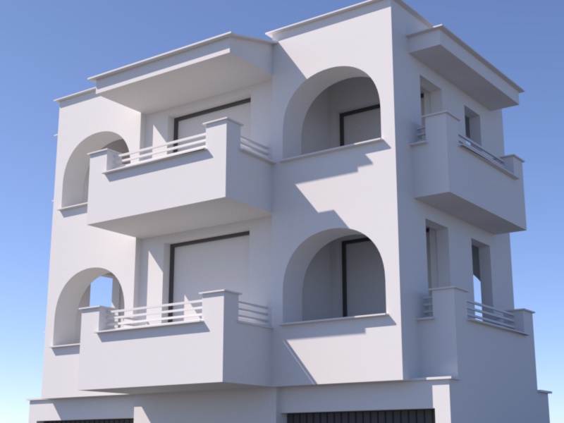

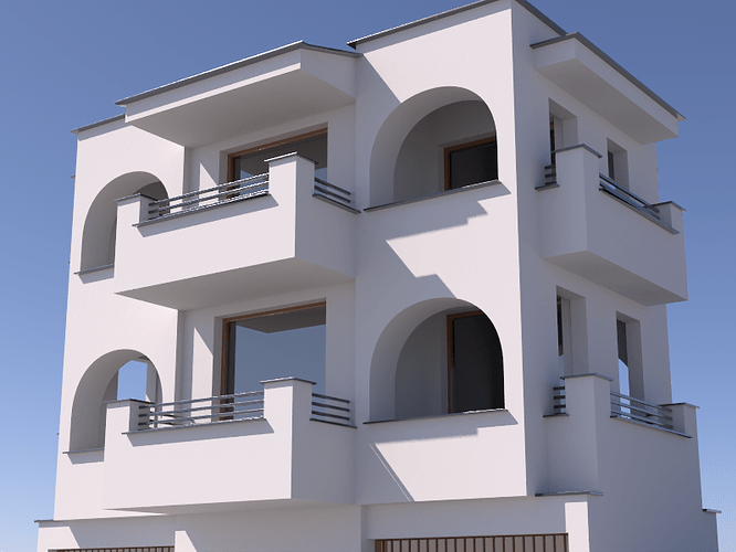

I think that current Pathtracing has too much visible contact shadows on corners. I compared this with other renderers which produce more soft-milky GI transition.
D5 :
Real photo :
D5 :
Redshift :
Corona :
As you see D5 GI corner shadowing is way too much pronounced.

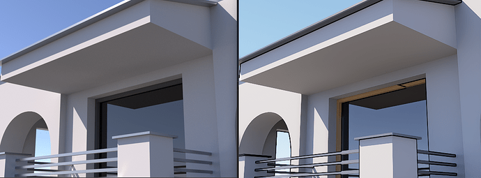

Old GI non Path Tracing method mixed with AO gives better results:
I found that using specular material with high roughness and little metallic looks near the same as Corona. It soften GI contact shadows on corners. Probably D5 needs roughness on diffusion channel too.
Without roughness:
With roughness and metallic :
Left is Corona.
Tweaked wall material :

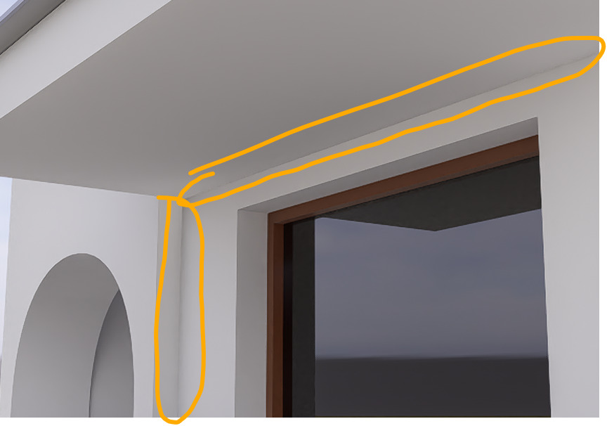

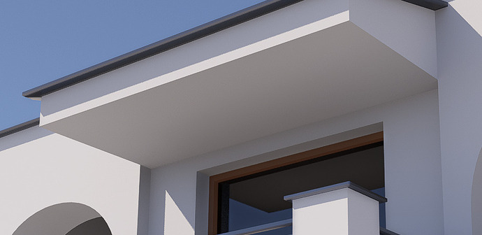

After some hours of investigation I see that implemented Path-Tracing doesn’t do job because D5 doesn’t support Diffuse Roughness like Oren-Nayar, EON.
Compared to other renders ( GPU too ) G5 Path-Tracing looks bad in some situations because of it. Diffuse roughness simulate micro-bumps that scatter light. GI shadowing is more softness. Actually it looks like elevation wall is smooth, polished.
If you can do roughness for reflections you can do that for diffuse too right ?

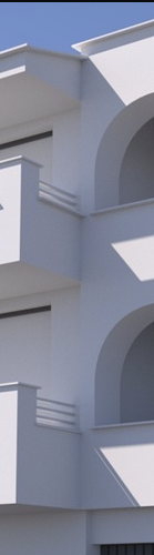

Also please see that D5 is only one renderer that doesn’t include shading in these areas :
Zrzut ekranu 2025-09-01 190005
Corona :
