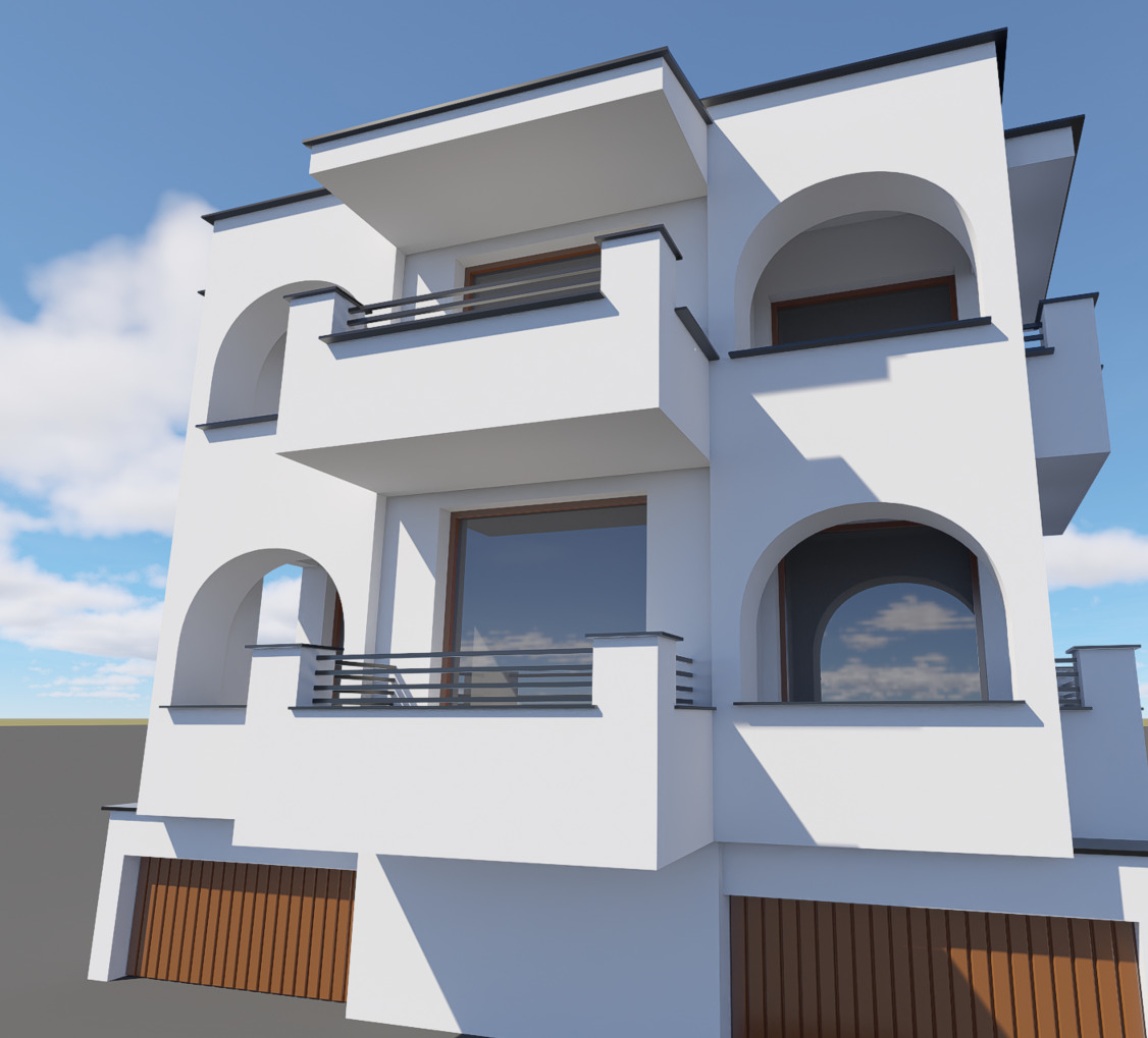

I think that current Pathtracing has too much visible contact shadows on corners. I compared this with other renderers which produce more soft-milky GI transition.
D5 :

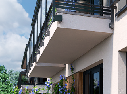

Real photo :

As you see D5 GI corner shadowing is way too much pronounced.

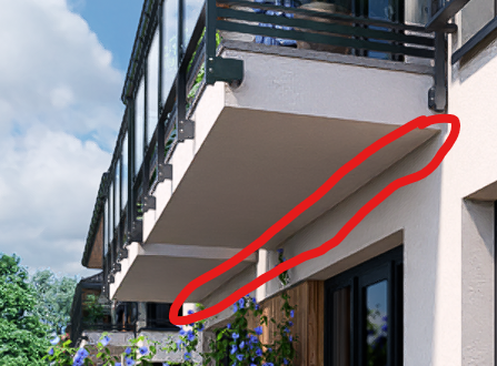

Also please see that D5 is only one renderer that doesn’t include shading in these areas :
Zrzut ekranu 2025-09-01 190005
Corona :
