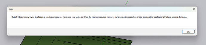

I was able to render without issues over the last few days, but now I’m having trouble syncing with skp and shows this message.
Hi @asddhaha
- Does this problem occur in other files? Or is it file-specific? (If empty, demo, or very light scenes has also a similar issue, it may be a bug that needs to be reported as soon as possible)
- Can you normally create new scene files or run D5 demo files? If the problem only occurs with the current project or some of the scene files, it is likely that the file is too large and is consuming too much video memory, exceeding the load of your current device, and you need to lighten and optimize your file.
- How heavy is this specific file?

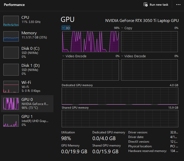

VRAM: Try to open this portion with your D5 file opened at the same time. Based on the image you sent, you only have 4GB of VRAM, which is generally inadequate for running heavy scene files.
