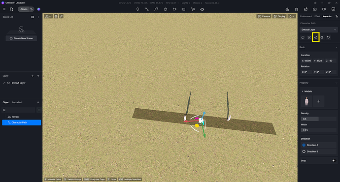

Hi there.
Have you tried editing the path using this button? Then, proceed to drag the path node (circle) in the direction you want.
Upon changing the length of my path, the character that I inserted seems to start at the edge of the path; hence, I can begin my character walk at Point A (Yellow arrow)
Let me know if this helps, thank you.
