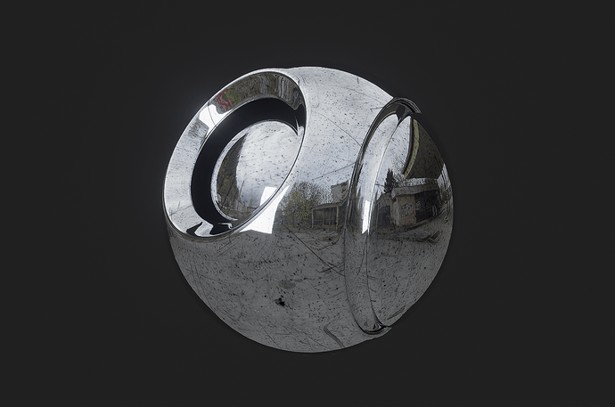

You can add an imperfections image to the AO slot for metals. Anything without a defined texture in the materials will work with this. I got an imperfections pack from DGruwier at Gumroad. You would have to invert the imperfections image. AO goes to 1. Below shows a before and after of Mirror Stainless Steel. You can try it with wood too I suppose.
