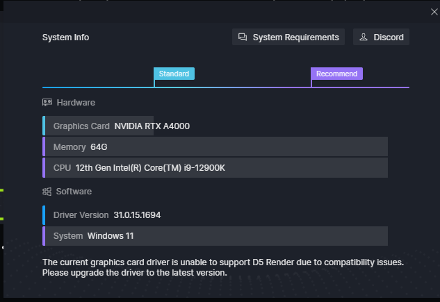

I am having an issue starting to use D5, even though I have a graphics card which is supported, and I have checked that I do have the latest drivers, can anyone help please
Hi @icleasby8

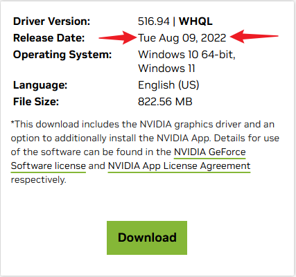

I believe your Graphics Card Driver Version is outdated. 516.94 or 31.0.15.1694 was released way back in August 2022.
Please update your Graphics Card Driver to its latest version via the NVIDIA App or by visiting their website. Official GeForce Drivers | NVIDIA

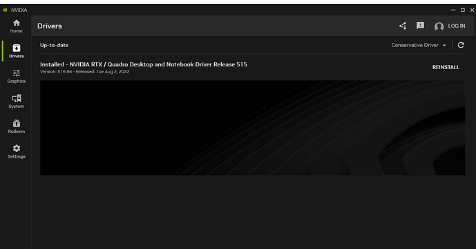

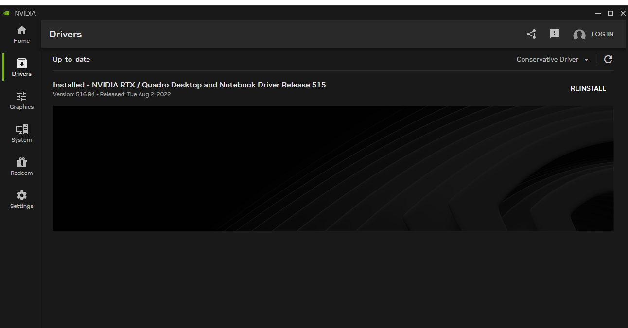

Hi
Thanks, I thought it was old, but the App says it is up to date and won’t show a link to a newer driver. The link you provided just takes me to the app and the app says its up to date. Do you have a link to the newest driver please?

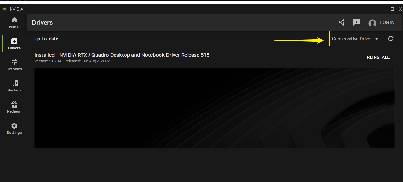

Hi @icleasby8
You might want to check first the options available in this drop down menu, consider changing to Recommended Drivers and see if you can update it to its latest version via the app

The second option sorted it, I had tried that before but this time it resulted in a new driver
