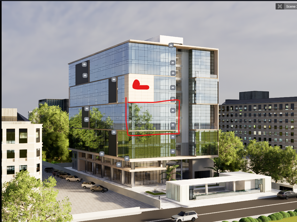

I have added vegetation to be reflected on the glass facade but beside one or two trees from the vegetation the reflection properties are somehow off for other assets.

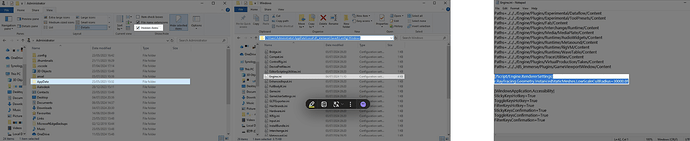

( No need to open D5 ) Find the file
C:\Users\XXXX\AppData\Local\d5_immerse\Saved\Config\Windows\Engine.ini -
Add the appropriate fields in the
Engine.inifile, modify the parameters and save. -
Restart D5, the relevant configuration changes will take effect.
