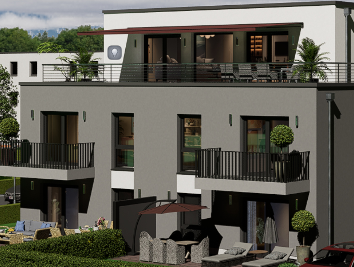

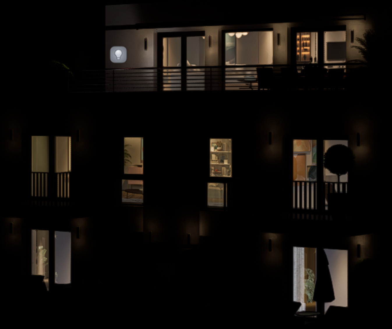

Hello,
After loading a project created in V3.1,
the light is missing.
If I select a different scene, everything works fine in that one.
But when I go back to the first scene, the light is on there, too.
Most of the time, anyway—not always.
This is some weird behavior from V3.1.
I have a PC with an RTX 5090 and 64 GB of RAM; the current graphics driver is 610.74.
Bye
Andreas
Hi @a.drexler
From what I understood from your description:
  • Opening the scene will result in a nighttime view (where the main light source disappears)
  • After switching to a different scene and then going back to the first one, it will revert back to its original view
  • And this always occurs in every file that you have? Or only to this specific one?
Which specific version are you running? Can you send us a screenshot?
2.11 Build Version

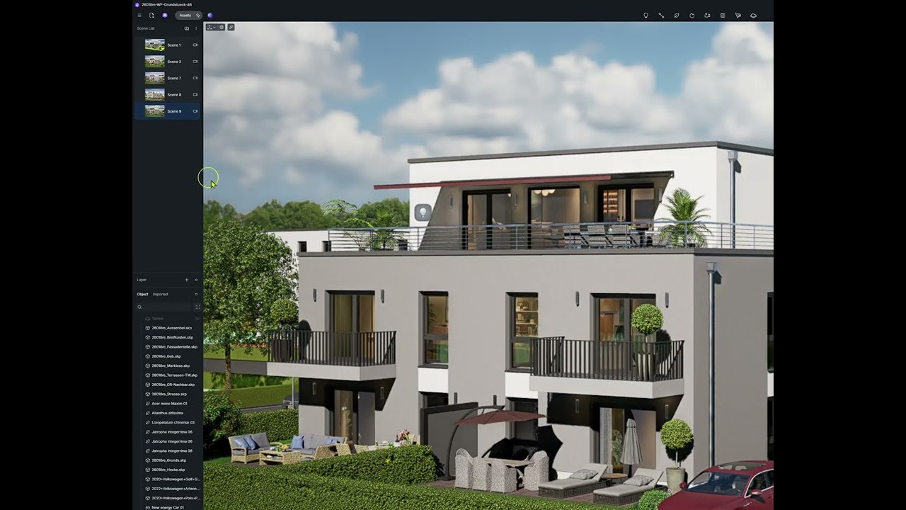

I use 3.1.0.0746
Here is the video you requested:
Hi @a.drexler
Are you able to send this file to us?
I have tested your file with the 3.1 hotfix, and it has already been resolved. Currently, the hotfix is in grayscale release; you may have received an update notification already. If not, please wait for the official release.
