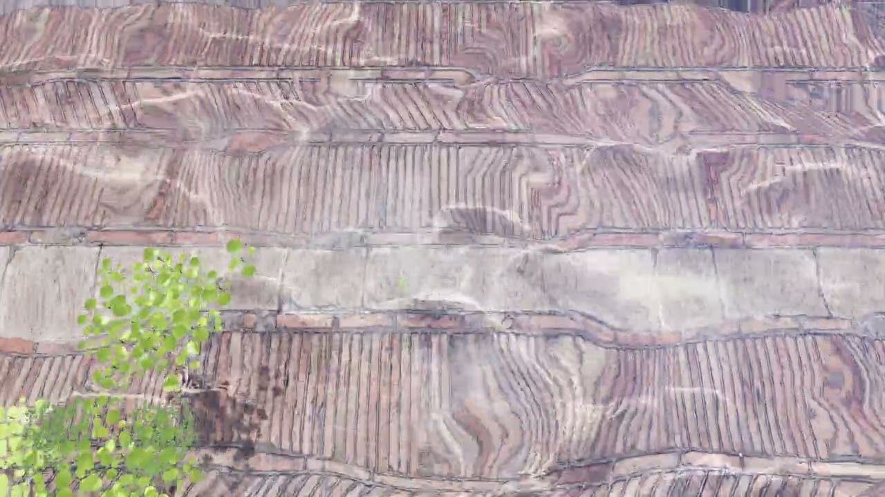

So to be more precise, scene 1 shows a swimming pool and I want to show water caustics.
Scene 2 is another part of the project.
If I adjust the sun caustics settings in scene 1 then save my settings by updating scene 1, and I switch to scene 2 when I go back to scene 1 caustics settings that I just saved are gone. They haven’t been saved.
The only way to render my caustics settings is by not switching scene and render it right away after I set it up. I can’t set several scenes with sun caustics and add them to render queue. Caustics settings are not taken into account.
In your demo video, do you have any material that has caustics on ?
I hope it helps !
Hi @Clov, here’s another interesting record :
If I set caustics intensity and softness to 1 each they are saved.
But if I set intensity to 2, softness to 0.2 and save
when I go back to scene 1, it’s been inverted :
Intensity has been saved to 0.2 and softness to 2 !
Thanks for your feedback on this !
Hi @tom.ya
Thank you for the thorough description and the helpful video recordings. We’ve reviewed the additional information you provided and have successfully replicated the issue. This confirms the bug, and we’re prioritizing a fix. Our team is actively working on a solution, and we’ll keep you updated on our progress. We appreciate your detailed report.
