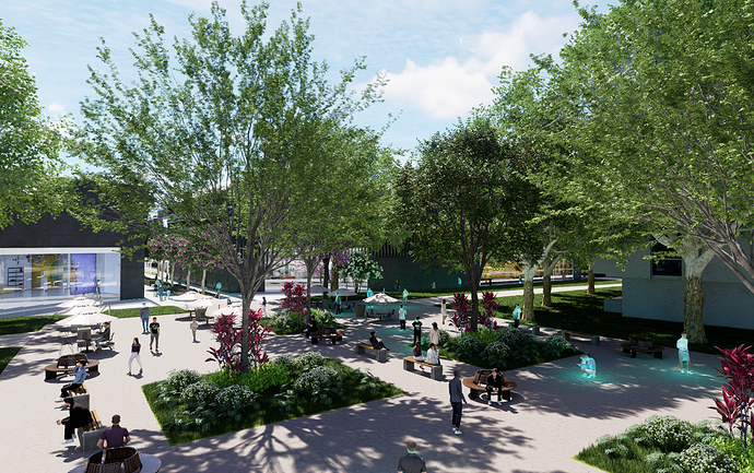

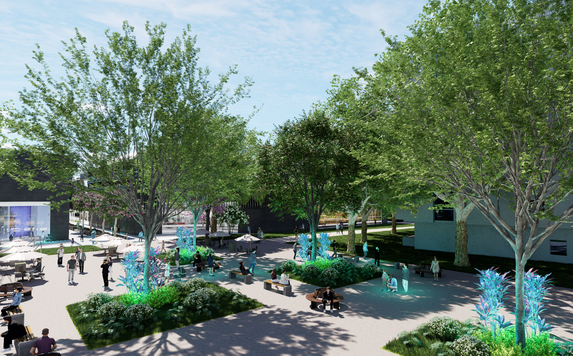

Hello, I am totally new to D5, however I have had other experiences in other rendering engines, however, in this one I had a problem, where when performing the render, a type of neon light is observed that certain objects emit, I already tried to activate the pressure option, I also tried with smooth but I don’t know what is causing this, Greetings from Mexico

Does this bright light appear in both preview and output?
Please click ‘L’ to active all lights in the scene and see if there are strange hidden lights.
If it’s convenient, can you send the scene file (The entire folder where the .drs file is located) to support@d5techs.com, and please describe the problem, I can check it for you.

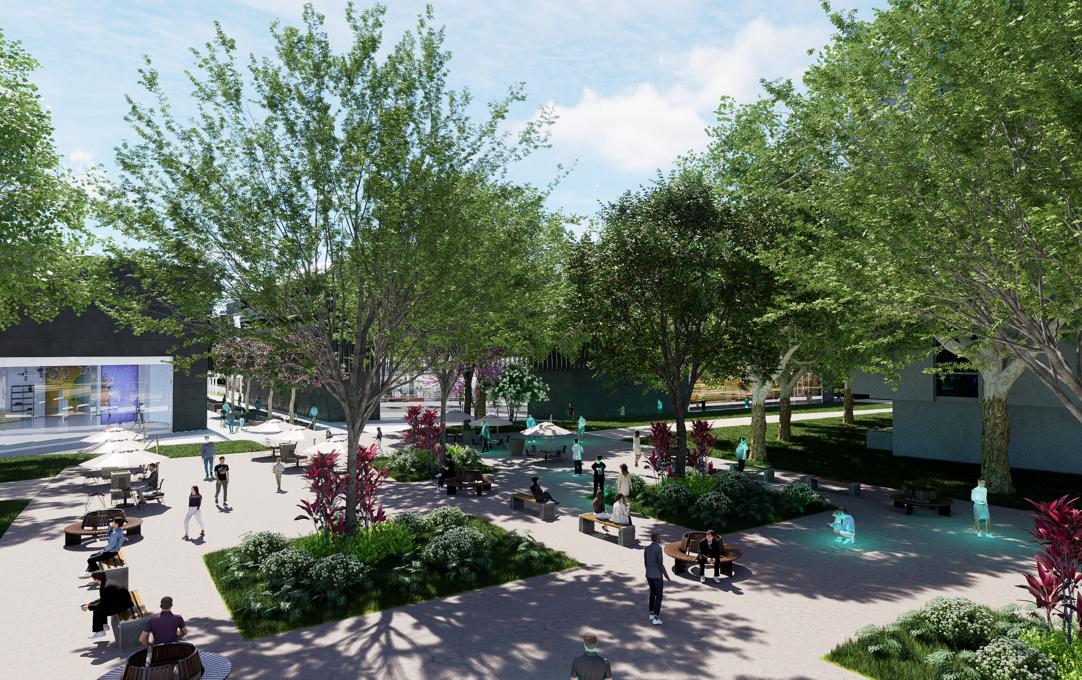

Hello, thanks for answering, I was able to solve it by updating the drivers of my graphics card, at least in my case that solved it.
