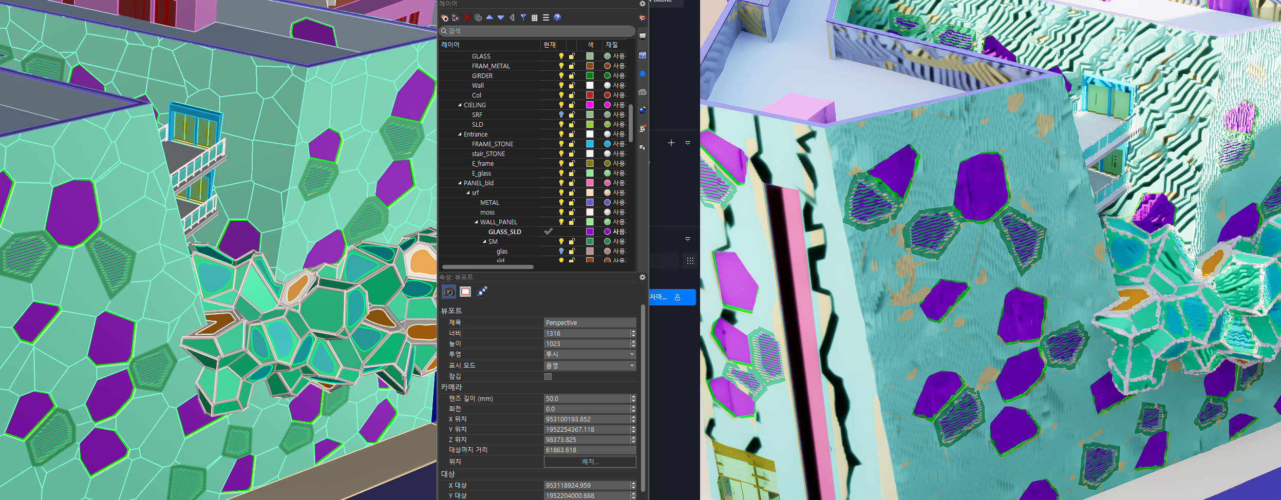

my render materials are image breaking into triangle pixels
And it’s showing my model way deformed from what it looks like. Even when i set materials as basic materials in the first place. I’m working on Rhino8.
Hi @jjsshh1211
I apologize for the inconvenience. Please check if your model in both Rhino in D5 is located far from the origin; if so, please move the model near the origin.
importRhino
importRhino.Geometry
importscriptcontextassc
importrhinoscriptsyntaxasrs
if__name__==“main”:
doc=sc.doc
bb=doc.Objects.BoundingBox
max=Rhino.Geometry.Vector3d(bb.Max)
min=Rhino.Geometry.Vector3d(bb.Min)
diagonal=bb.Diagonal
print(“Boundingbox:\nMax:{}\nMin:{}\nCenter:{}\nDiagonal:{}”.format(
max,min,bb.Center,diagonal))
rs.MoveObjects(doc.Objects,-bb.Center)
