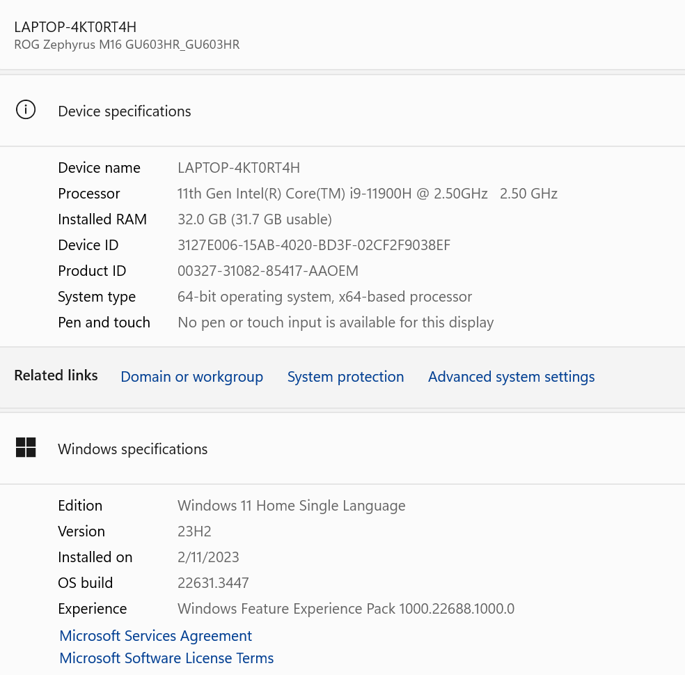

These are my device specs:
I really appreciate your help. Thank you!

I suppose you don’t need to worry about lag after upgrading your graphics card driver.
In your case, you had better install a graphic card driver at least above 31.0.15.3114 if you do not want to upgrade it to the latest version. You are using windows 11. The system version and the driver version need to match in order for the D5 to run properly.
