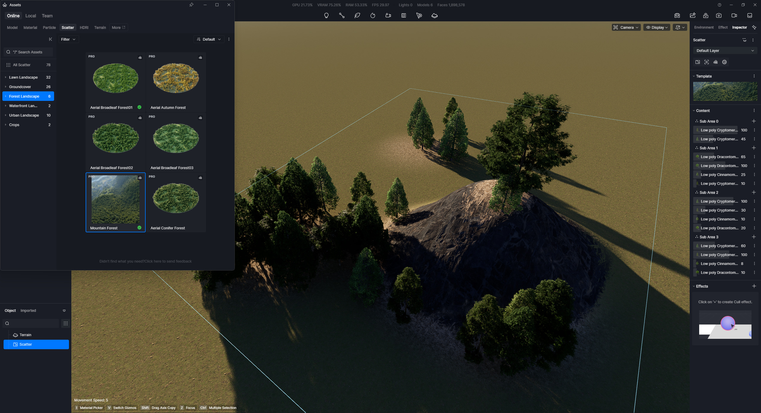

I’m having trouble applying the mountain forest scatter pattern. I click on the thumbmail, it loads for a while, and then nothing happens. I can’t apply the scatter to the area. I tried doing a clean data and nothing. I can’t apply this preset to any of my projects.

@Clov So far I’ve checked what happens with Aerial Broadleaf Forest01, Aerial Broadleaf Forest03, and Mountain Forest. When I click as shown in the video, it loads for minutes and then nothing happens. Note that when I click on Aerial Broadleaf Forest02, it works normally.

Yes, those files were opened while located on an external drive (on the network). However, the WorkSpace folder is on a local drive, as I mentioned.
I tried copying the scene file to a different location specifically, to the same local drive where the WorkSpace folder is located but the problem persists.
I don’t think the external drive is the issue, because there are other Scatter setups that work fine. Also: the “loading” indicator now just spins indefinitely on the screen, as if it were frozen.
Just a reminder: this also happens with Aerial Broadleaf Forest03, Aerial Broadleaf Forest01, tree pit07 and tree pit04.
I need a solution for this.
