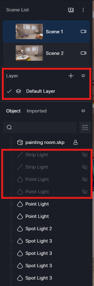

It also helps to use layers to hide large groups of objects you’re not currently working on, like turning off all vegetation while adjusting lighting. This reduces the real-time load on your GPU and makes editing smoother.
