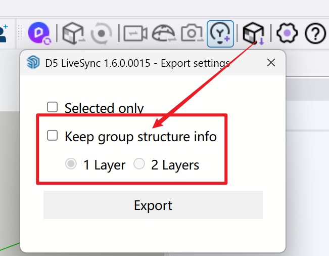

What are the correct import/Live Sync settings to keep the hierarchy (and avoid “merge by material”)? If it’s already in D5 as one chunk, is there a way to “Uncombine/Separate” it inside D5? Any step-by-step guidance would be appreciated.

Surfaces that are meant to have different materials should be differentiated in SketchUp first; for instance, walls should be different from the ceiling material.
  • If you prefer your model’s object to be retained, you can use this option in our SKP Plug-in.
More information: Feature Introduction | D5 LiveSync for SketchUp | User Manual
