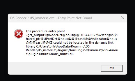

hi, I just downgrade my d5 from 2.11 to 2.10 because there were many bugs. now when I launch the D5 , the notifications show this. how do I fix this? thank you
I suggest reinstalling again. Please delete 2.11 and 2.10 completely from your device, including the launcher, then download the version you want to use.
- May I also what bugs you have encountered with the new version?
Hi, I’ve reinstalled D5, but the problem still persists. Could you please send the nous_nurbs.dll file directly? Thank you!

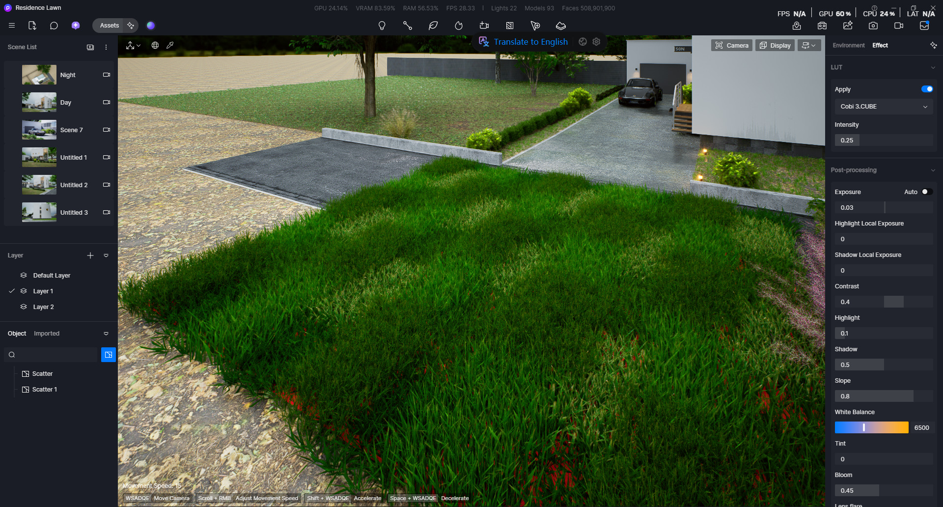

- The grass scatter doesn’t fully cover the plane — there are empty patches along the edges.

- After you have uninstalled D5 completely, please check if there are folders that have remained; you can manually delete them. Then try reinstalling again.
- If the issue persists, try installing it in another file address.
- Is it specific to certain surfaces only? I tried it on my end and the grass scatter does not have any empty patches and fully covers the plane. How does it look in 2.11 vs 2.10?
