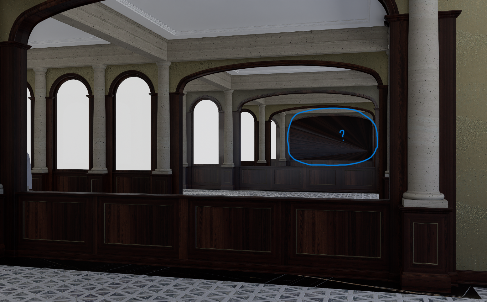

  1. First has the dark reflection issue been fixed? Left image is pre render, right image is after rendering:

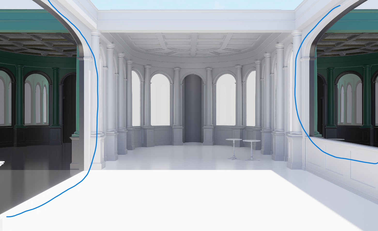

  1. Why are the mirrors in clay model setting reflecting color?

Hello! Thanks for your reporting.
For the first problem, We checked this before and this is currently a known issue with rendering. You can temporarily fix this by lowering the metallicity of the material or increasing the roughness of the material.
Regarding the second issue, I suggest you can send us the file and we will check what caused this problem.

As for the clay model setting, I applied the mirror to this cube, turned on clay model setting, and you can see the reflection is in color:
Sorry for this issue. Is it convenient for you to send us scene with the clay model issue? This may help us check the problem.
You can share a link here or send your file to our email. (support@d5techs.com, please describe the problem and attach the link of this post to your mail)
