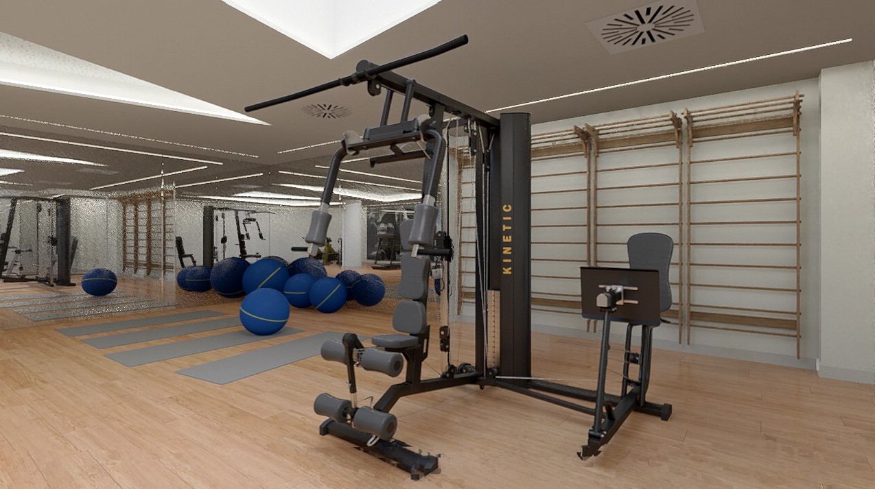

I have encountered issues when rendering video of a mirror.
This renders fine as still image but in video it has severe crispy noise problems.

Thank you for posting here. From the screenshot, it is a screenshot of video rendering, right? Please turn off auto-exposure, then adjust the lighting, also the Specular and Normal of the mirror materials.
Second, currently it is a known problem that the mirror material does not perform very well when rendering a video, and we are working on solving this problem. Also you can try rendering video sequence, then check the result.

That is a screenshot from a video, yes. You can see there the problem with mirror.

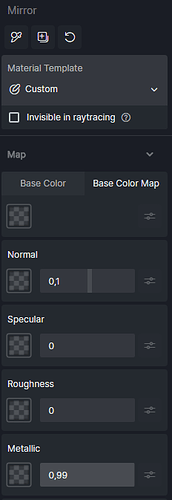

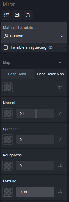

about the mirror material, y did changed various settings and found no change. This is what i have now.
