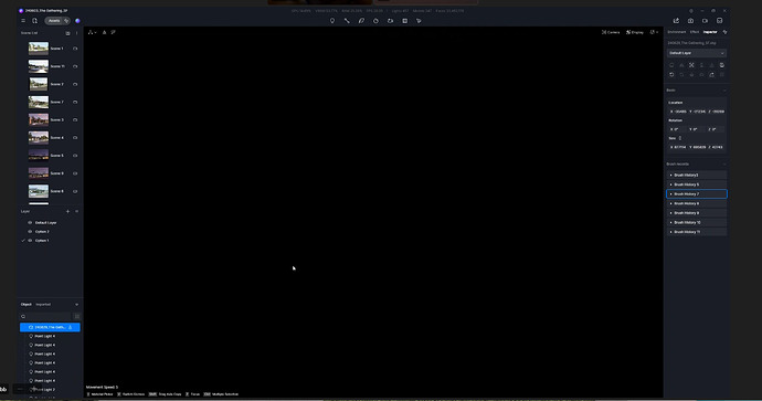

We use Microsoft Teams for internal and external client meetings and recently noticed that we cannot share our screen with D5 Render. The general interface shows but for the actual View port is blank. See image:

Hello, sorry for this. May I ask if this was shared through “Window” or the “Screen” itself? Thank you for letting us know about this issue we will also be conducting a test on our end.
We use Window.
Hello, we were able to test this issue on our end, but the problem was quite different. The general interface won’t show (black screen) on our side while the render preview shows. There seems to be no issue if we share the entire “screen” instead of just the “window”, but if this is not viable on your side (privacy issues). I found similar issues from their forum; I’ll also include the link, so you may want to check it out. Thank you~
