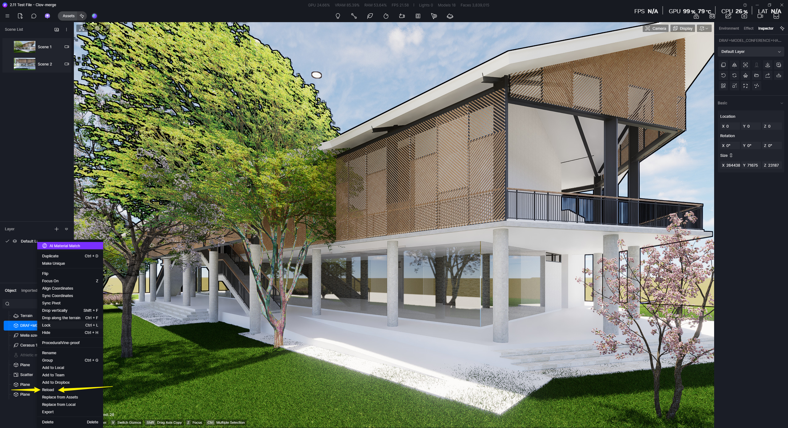

Just to clarify, you want to reload the 3d file that is inside the merged D5 file? I just tried it with a merged file, and the reload is present.
Note: The models are from SKP
