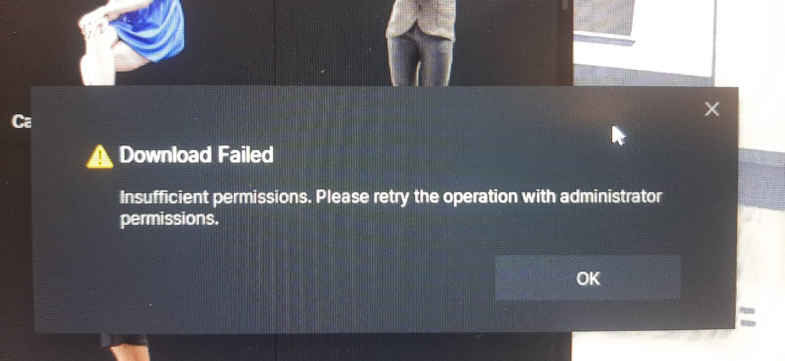

No materials or objects are loaded

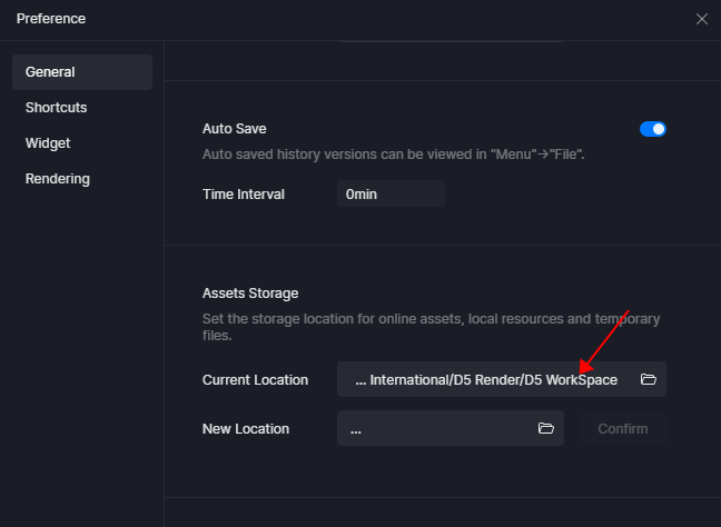

Hi mate, The Workspace folder is in a directory that requires administrator rights. Therefore, you need to run D5 with administrator rights in order to download and update materials.
Alternatively, you can migrate the Workspace directory here. Please make sure the path you have admin rights to use.
