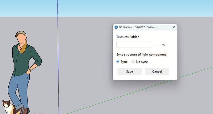

3 – This is the version of the plugin that I am using:
Please let me know if this makes it clearer and if you have any additional suggestions to prevent this from happening.

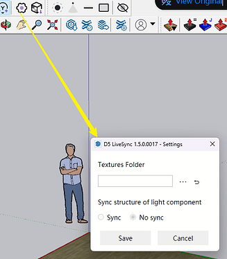

  • When you sync your SKP file to D5, it will create a folder containing the different textures that were used in SKP, which will then be used by D5. This folder will help retain the texture information.
  • Try inputting its location after the file transfer then see if it will display normally in D5

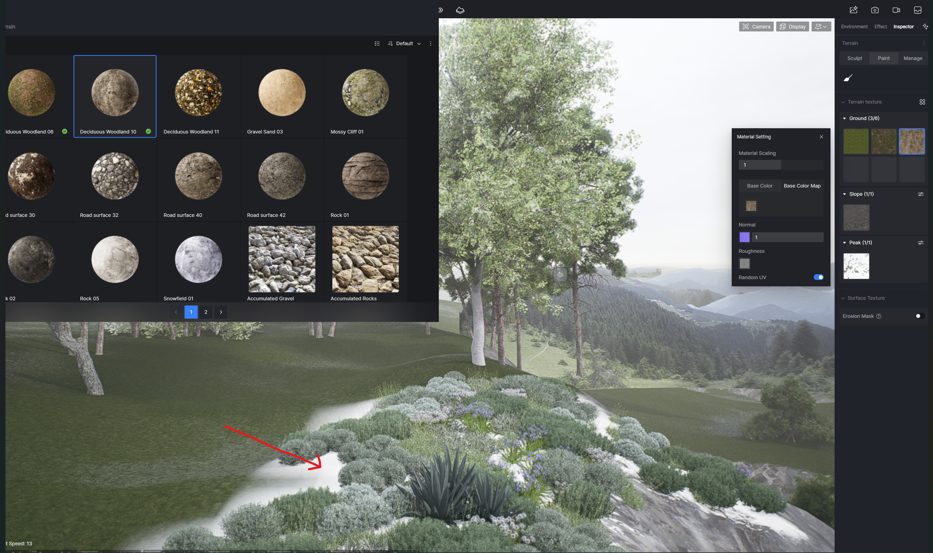

  • These base colour maps were not inserted in SKP. This happened with a D5 included material, in particular it was a terrain texture that was used to paint the terrain in D5 (see screenshot attached, the terrain material appears white in that area).

  • Since you have mentioned keeping a backup and storing it in your cloud storage. I’m assuming that this file is the main file and is also being stored in your cloud storage? If so, we don’t recommend placing them there while you’re editing it since it will cause some issues like losing material information; hence, we recommend placing it locally. We will be optimizing this workflow sooner.
  • If this file was stored locally, let me know. We may need to collect your file for testing.
