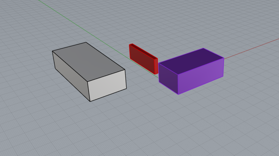

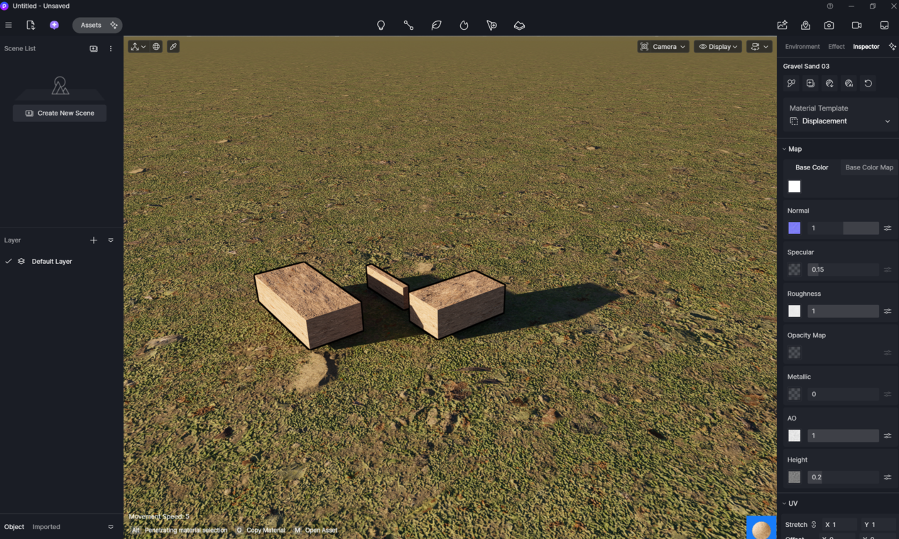

Hi, I’ve been using vray for a while and wanted to try d5. Currently in my rhino file when i try to apply a material to one specific geometry it applies to it all geometries in the scene and not sure why. I asked a friend and they said my geometries need to be on different layers which I already had done iin my work flow. Then I opened a new file and texted d5 on three boxes in different layers and it applied the same material on all boxes could someone help me out?
Hi @jaidenprakash6767
In this case, the issue is likely caused by the materials having the same name in your Rhino file. When materials share the same name, D5 Render may recognize them as a single material group during synchronization, affecting all objects at once.
Please assign unique material names to each object before syncing. This ensures D5 recognizes them as separate objects and allows individual material control.
