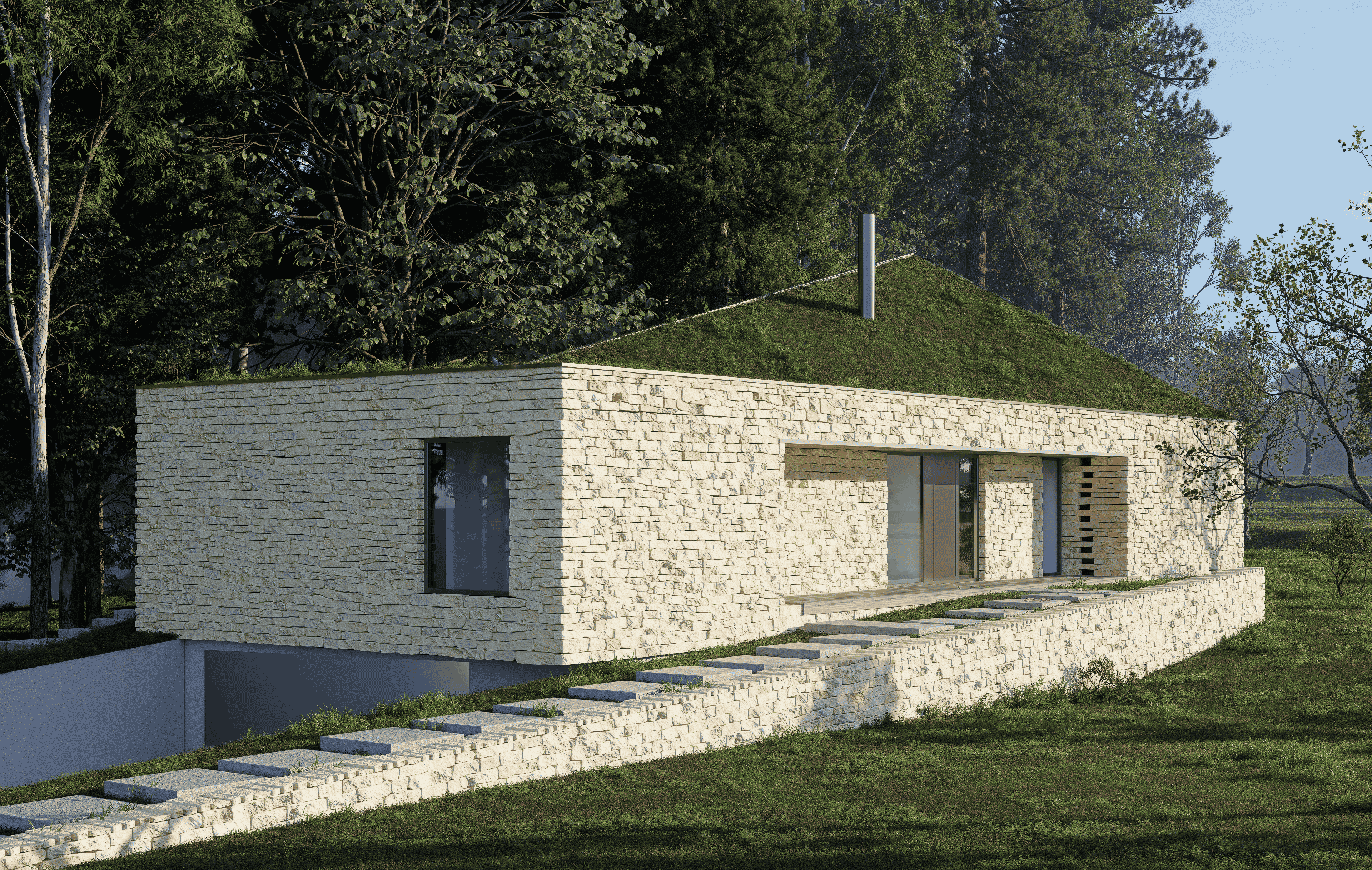

Hi
I was setting a camera view for the corner shot of a stone house. Meaning there are many edges in which the materials are applied.
But as the camera moved down, the material maps on some stones were also shifting, making the shot look strange.
Here is the example.
Clip3_3-ezgif.com-crop
Is there a way to solve this issue ? Thanks

I just tested your file, disabled FPS Booster and rendered it. Can you please confirm if the resulting video is the same on your end?
  • Disabling FPS Booster might improve the quality
