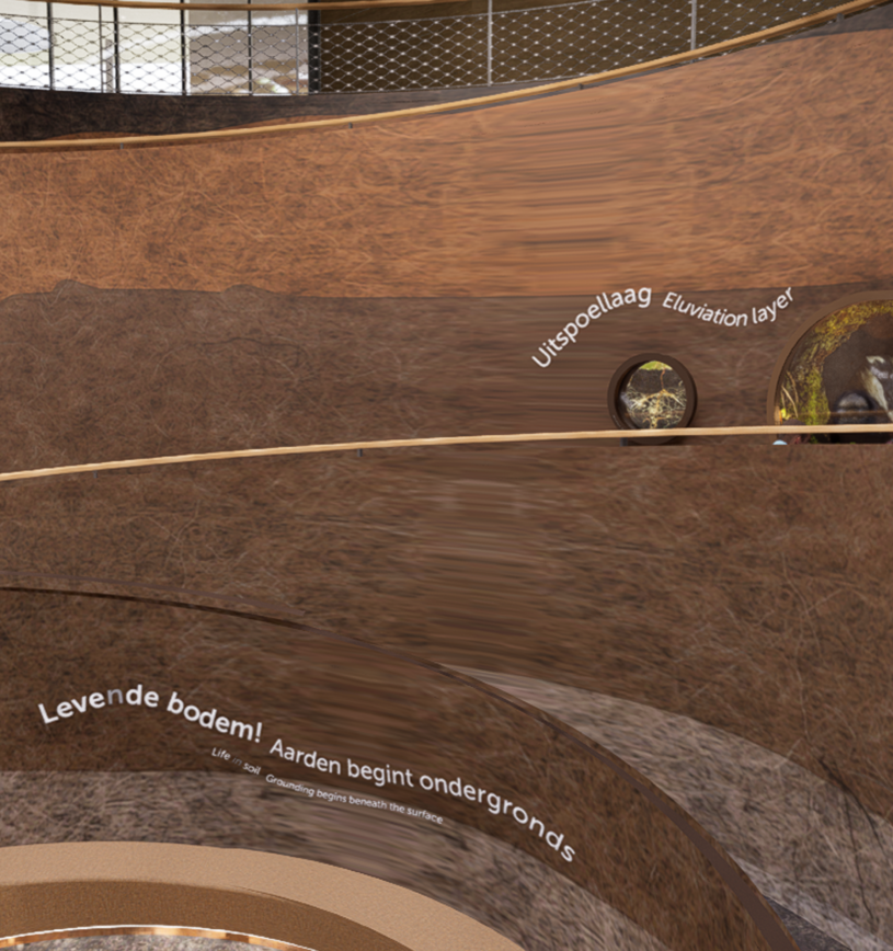

Hi,
This material is stretched out on a curved wall. It happends on more walls with other materials too. I don’t wanna use triplanar because the materials goes out of place and then I can’t get it to the right position. How can I fix this?
Hi,
Hi @studiorendera This issue may occur if your model is too far from the world coordinate origin (0,0,0). Please move the model closer to the origin, ideally with the center of the model at coordinate (0,0,0).
Was the file imported directly or through the sync plugin?
