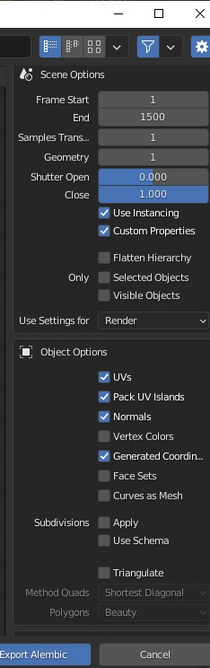

I tried assigning different materials to one object in Blender like the image below. But when exporting the .abc file via D5 Render, it no longer recognizes the material ID. I can’t adjust the glass or many other materials for doors, wheels, etc. Is there any adjustment in the settings when exporting abc files from Blender to D5?

Hello, the way I export the model from Blender to D5 with abc file is the same as yours. But I don’t understand why mine doesn’t recognize the material ID @@

Hello. Currently D5 does not support abc file import with material. But you can do the material distinction in the modelling software first, and then add the material after importing into D5.
